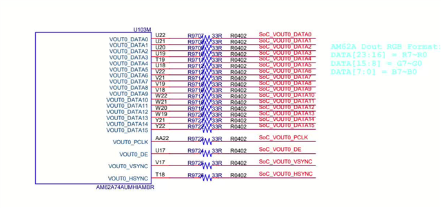

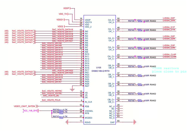

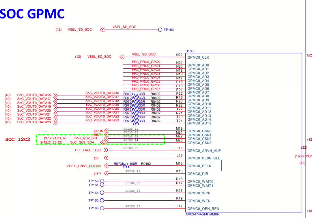

Hi Ti Experts.
Following this post, I modified my device tree and compiled the application for the development board.
I logged into the system and ran kmsprint,
but nothing was output.
Here is code in my dts file about display ,Following your suggested test code
	panel {
			compatible = "newhaven,nhd-4.3-480272ef-atxl";
			port {
					panel_in: endpoint {
							remote-endpoint = <&dpi1_out>;
&dss_ports {
	/* VP2: DPI Output */
	hdmi0_dss: port@1 {
		reg = <1>;
		dpi1_out: endpoint {
			remote-endpoint = <&panel_in>;
I noticed some errors.
[ 0.440458] /bus@f0000/dss@30200000: Fixed dependency cycle(s) with /panel
[ 0.447554] /panel: Fixed dependency cycle(s) with /bus@f0000/dss@30200000
[ 0.821931] panel-simple panel: supply power not found, using dummy regulator
    Please share your complete dts and also try running kmstest to check if you see anything on panel.
    Also, what do you mean by 'hot enable DPI'?

  • and here is the hardware of the soc dpi output:

  • i check with the hardware that the pin GPMC0_BE1n/M18 is not set during startup.
    i have check with the sysConfig. that i do not see that the register value below have be generated. can you help let me know where is get the pinctrl-single,pins value. thanks very much
    usr_led_pins_default: usr-led-default-pins {
    pinctrl-single,pins = <
    AM62AX_IOPAD(0x244, PIN_OUTPUT, 7) /* (D18) MMC1_SDWP.GPIO1_49 */
    can you help me with the problem. thanks very much
