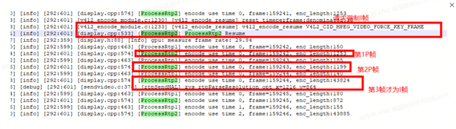

We have a requirement for mandatory keyframe insertion in the project, but occasionally there may be delays in the effectiveness of keyframe insertion. The meaning is that I found that in the continuously captured frame data, the keyframe only appeared in the third frame by configuring V4L2_CID_SPEGVNet EO-FORCE_KEY_CRAME.
Do you have any software recommendations for forcibly inserting keyframes?
At present, the software has created three encoding channels based on the/dev/video1 device node. If these three encoding channels do not use a locking mechanism, will there be any problems?

    Yes, we did not use Gstreamer, it was based on CPU loading considerations. The current flow is: capture node ->ldc node ->v4l2h265enc ->rtp ->IHU decode

    I think you misunderstood my meaning. In most cases, setting V4L2_CID_MPEG_VIDEO_FROCE_KEY_FRAME can indeed successfully set IDR frames. The current issue is that during our testing process, we have encountered a situation where after setting V4L2_CID_MPEG_VIDEO_FROCE_KEY_FRAME, there are two consecutive frames of P frames followed by I frames. We hope that the first frame after setting V4L2_CID_MPEG_VIDEO_FROCE_KEY_FRAME will be an I frame.

    Yes. At present, we have found that there are 3 buffer buffers. After dynamically inserting keyframes, there may be non keyframe data in the buffer buffers, and it is possible that non keyframe data will be sent out. Currently, we have performed a buffer clearing operation and no abnormalities have occurred. This issue will be temporarily closed for now.
