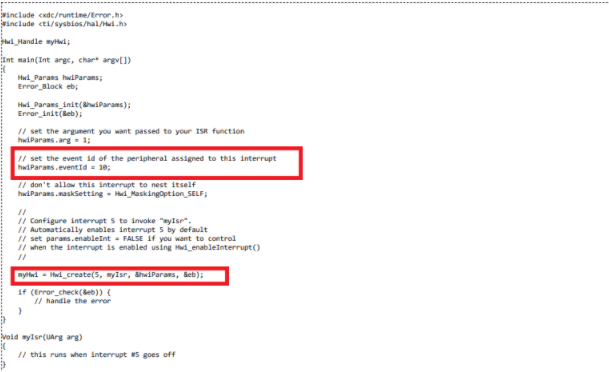

  • Hi Amir,
    Looks good.
    Please explain on what basis the correct value of hwiParams.eventId and the first argument of Hwi_create should be assigned, and what they should be.
    HWi_create API argument definition is clearly mentioned the Bios_User_Guide(Attached the screenshot) [ you can also see an example from the document].
    id ---> Interrupt number (CPU Vector) i.e Which ISR slot to use.
    HWi_Create API usage:
    hwiParams.eventId is the peripheral interrupt event number. (These numbers are mentioned in TRM as you mentioned above).

  • Hi Amir,
    The value of id ---> Interrupt number for EDMA3 Transfer Complete is determined from which table or document?
    As mentioned earlier, the ID refers to a CPU interrupt number (INT4 - INT15). Have you had a chance to try using it yet?
    The value corresponding to the macro CSL_INTC0_CPU_2_EDMA3CCINT0 is mentioned in the file cslr_device.h. (corresponding dec value is 38).
    Are you still experiencing the same issue?
