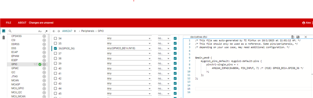

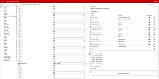

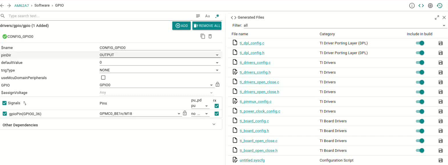

Hi Ti Experts,
i need to using the GPIO0_36 to control the hardware device. and i have used the sysConfig to generate the code and dts file
below is the setting
my question is that in the device tree the default-pins  register  should be set below, but i donot get this information in SysConfig tools
can you help to check the problem. and let me know what should i do step by step to config the pin. thanks very much
usr_led_pins_default: usr-led-default-pins {
pinctrl-single,pins = <
AM62AX_IOPAD(0x244, PIN_OUTPUT, 7) /* (D18) MMC1_SDWP.GPIO1_49 */
Best Regards
Meng
