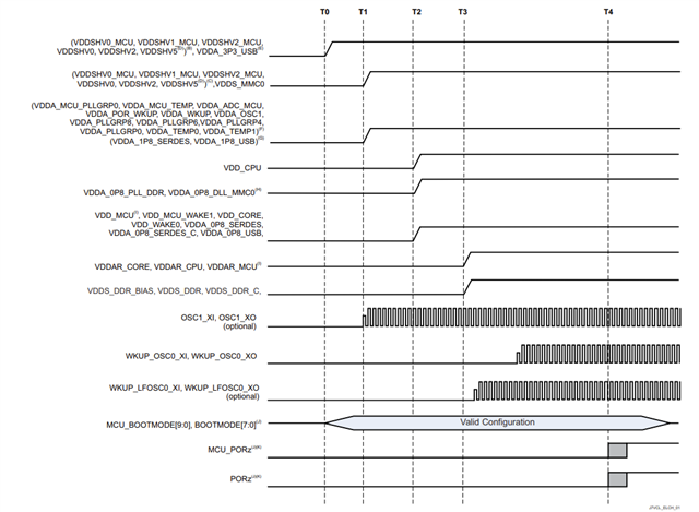

We have a custom board with DRA821U.
We are having problems with the initial booting following this application note: spradc5.
We have the same PMIC as the Evaluation Kit (slvuby7a).
We have checked that all signals are working as provide in datasheet Figure 7-3:
We put bootmode pins into DFU mode, to try to check if the processor try to boot in DFU mode, but the host PC didn´t detect the DFU target (spracy5).
We are not sure about how to check if the processor is at least booting and running DMSC ROM code and MCU ROM code.
The idea behind booting in DFU mode was to check that at least MCU ROM code was running.
What would be the ideal way to debug the boot processor in this stage of our design?

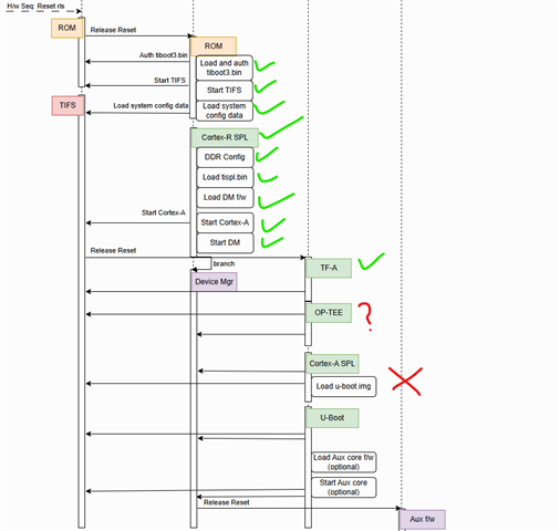

    idle-states
    We’re currently using the default Device Tree for the EVM; we haven’t optimized it yet since we first want to verify that we can boot our custom board with this configuration.
    We also tried removing the SERDES configuration because we thought it might be causing the “idle-state” issue, but the behaviur is the same. However, when reaching this state, the processor resets after a while.
    What this "idle-state" means and, how can we solve it?
    An which point of the u-boot diagram boot flow are we currently stuck? Are we stuck in OP-TEE? Before this? We are not sure:
    Thanks for the help.

  • Hi Santi,
    EEPROM i believe is not present on your custom board? I am yet to dig deeper into idle states.
    Do you have a debugger? Is A72 hanging at U-Boot stage?
    - Keerthy
  • Hi Keerthy,
    Yes, that’s correct our custom board doesn’t have an EEPROM, so we’re unable to read the device ID. Could this be an issue? Is the board revision detection required for the boot process to continue?
    At the moment, we don’t have a debugger available for the custom board (there’s no connector or routed traces to the processor). However, it seems like this will be necessary in the future, so we’re planning to include a connector in the next PCB revision.
    We do have the J7200 EVM, but we haven’t tried using the debugger integrated with the J721E EVM yet. Could you please guide us on how to get started with the debugger on the EVM? Also, would it be possible to reproduce the same boot failure on the EVM while using the debugger?
    No, it’s not. We’re uploading all the .bin files through UART, but we never reach the stage where u-boot.img is ask to be loaded, so it’s getting stuck at tispl.bin.
    Thanks a lot for the support.

    idle-states
    As you can see, we’re still getting stuck at the same stage after applying the changes, so it seems the patch doesn’t have any effect.
    When the “idle-states” log appears, the system freezes and we cannot load the next stage (u-boot.img).
    Just to remind you in case it’s relevant we are loading all the boot files through the MCU UART.
    Santi
  • Hello Santi,
    Does the core crash after this? Are you able to attach a debugger and see if this is crashed or a loop?

    SYSFW ABI: 4.0 (firmware rev 0x000b '11.0.9--v11.00.09+ (Fancy Rat)')
    Esta traza es nuestra
    EEPROM not available at 0x50, trying to read at 0x51
    Reading on-board EEPROM at 0x51 failed -121
    Trying to boot from UART
    CCCCCCCCCe
    Skipping authentication on GP device
    Loaded 1064507 bytes
    Loading Environment from nowhere... OK
    init_env from device 7 not supported!
    Starting ATF on ARM64 core...
    NOTICE:  BL31: v2.12.0(release):11.00.09-dirty
    NOTICE:  BL31: Built : 15:51:25, Oct  2 2025
    U-Boot SPL 2025.01-ti-gac2433f99366-dirty (Oct 14 2025 - 14:39:52 +0200)
    single-pinctrl pinctrl@4301c068: configuring pins for wkup-i2c0-default-pins
    single-pinctrl pinctrl@4301c068:   reg/val 80477af8a/0x00060000
    single-pinctrl pinctrl@4301c068: configuring pins for wkup-gpio-default-pins
    single-pinctrl pinctrl@4301c068:   reg/val 81fffc08a/0x00050007
    single-pinctrl pinctrl@4301c000: 13 pins
    single-pinctrl pinctrl@4301c000: configuring pins for mcu-fss0-hpb0-default-pins
    single-pinctrl pinctrl@4301c000:   reg/val 81fffc48a/0x00010001
    single-pinctrl pinctrl@4301c000:   reg/val 81fffc48a/0x00050001
    Previo a idle-states
    mux-controller@47000004
    idle-states
    POST idle-states
    We have added some traces as you can see, just to be sure we were compiling right the files...

  • I think i found the culprit thanks to the detailed logs.
    Patch:
    iff --git a/board/ti/j721e/evm.c b/board/ti/j721e/evm.c
    index 11635d3d..449d1f0b 100644
    --- a/board/ti/j721e/evm.c
    +++ b/board/ti/j721e/evm.c
    @@ -179,6 +179,8 @@ int do_board_detect(void)
     int checkboard(void)
    +       return 0;
            struct ti_am6_eeprom *ep = TI_AM6_EEPROM_DATA;
            if (do_board_detect())
    @@ -455,6 +457,7 @@ static void setup_serial(void)
     int board_late_init(void)
    +       return 0;
            if (IS_ENABLED(CONFIG_TI_I2C_BOARD_DETECT)) {
                    setup_board_eeprom_env();
                    setup_serial();
    @@ -467,7 +470,6 @@ int board_late_init(void)
            if (board_is_j721e_som())
                    configure_serdes_sierra();
    -       return 0;
     #endif
    @@ -535,18 +537,4 @@ void spl_board_init(void)
                    if (ret)
                            printf("ESM PMIC init failed: %d\n", ret);
    -       if ((IS_ENABLED(CONFIG_TARGET_J7200_A72_EVM) || IS_ENABLED(CONFIG_TARGET_J721E_A72_EVM)) &&
    -           IS_ENABLED(CONFIG_HBMC_AM654)) {
    -               struct udevice *dev;
    -               int ret;
    -               ret = detect_SW3_1_state();
    -               if (ret == 1) {
    -                       ret = uclass_get_device_by_driver(UCLASS_MTD,
    -                                                         DM_DRIVER_GET(hbmc_am654),
    -                                                         &dev);
    -                       if (ret)
    -                               debug("Failed to probe hyperflash\n");
    Clue:
    This gave me a clue for Hyperbus. Mostly on your board this is getting probed while not being present.
    Let me know if this helps. Since I have no way to reproduce this issue, I will need your help to test.
    - Keerthy
  • Hi Kerthy,
    You were right!
    With your suggestion, we managed to reach the stage where u-boot.img is loaded. You can see it in this log:
    a00006a3776636c00000000000000475020200000020000000200CCCCCCCCCCCCCCCCCC
    U-Boot SPL 2025.01-ti-gac2433f99366-dirty (Oct 16 2025 - 12:21:50 +0200)
    CCCe
    Loaded 1064115 bytes
    U-Boot SPL 2025.01-ti-gac2433f99366-dirty (Oct 16 2025 - 12:21:26 +0200)
    CCC01000000011a00006a3776636c00000000000000475020200000020000000200CCCC
    CCvice
    CCCdevice
    Loaded 1318315 bytes
    single-pinctrl pinctrl@4301c068:   reg/val 81fffc88a/0x00050007
    U-Boot 2025.01-ti-gac2433f99366-dirty (Oct 16 2025 - 12:21:26 +0200)
    SoC:   J7200 SR2.0 GP
    Model: Texas Instruments J7200 EVM
    DRAM:  2 GiB (total 4 GiB)
    POST idle-states
    POST idle-states
    ti_sci system-controller@44083000: ti_sci_of_to_info: Acquiring notify channel failed. ret = -61
    single-pinctrl pinctrl@4301c068: 59 pins
    single-pinctrl pinctrl@4301c068: configuring pins for mcu-uart0-default-pins
    single-pinctrl pinctrl@4301c068:   reg/val 0x000000004301c0f8/0x00050000
    single-pinctrl pinctrl@4301c068:   reg/val 0x000000004301c0fc/0x00010000
    single-pinctrl pinctrl@4301c068:   reg/val 0x000000004301c0f4/0x00050000
    single-pinctrl pinctrl@4301c068:   reg/val 0x000000004301c0f0/0x00010000
    Core:  109 devices, 32 uclasses, devicetree: separate
    Flash: single-pinctrl pinctrl@4301c000: 13 pins
    single-pinctrl pinctrl@4301c000:   reg/val 0x000000004301c000/0x00010001
    single-pinctrl pinctrl@4301c000:   reg/val 0x000000004301c004/0x00010001
    single-pinctrl pinctrl@4301c000:   reg/val 0x000000004301c02c/0x00010001
    single-pinctrl pinctrl@4301c000:   reg/val 0x000000004301c030/0x00010001
    single-pinctrl pinctrl@4301c000:   reg/val 0x000000004301c008/0x00050001
    single-pinctrl pinctrl@4301c000:   reg/val 0x000000004301c00c/0x00050001
    single-pinctrl pinctrl@4301c000:   reg/val 0x000000004301c010/0x00050001
    single-pinctrl pinctrl@4301c000:   reg/val 0x000000004301c014/0x00050001
    single-pinctrl pinctrl@4301c000:   reg/val 0x000000004301c018/0x00050001
    single-pinctrl pinctrl@4301c000:   reg/val 0x000000004301c01c/0x00050001
    single-pinctrl pinctrl@4301c000:   reg/val 0x000000004301c020/0x00050001
    single-pinctrl pinctrl@4301c000:   reg/val 0x000000004301c024/0x00050001
    single-pinctrl pinctrl@4301c000:   reg/val 0x000000004301c028/0x00050001
    idle-states
    POST idle-states
    "Error" handler, esr 0xbf000002
    elr: 000000008085739c lr : 000000008085733c (reloc)
    elr: 00000000ffef839c lr : 00000000ffef833c
    x0 : 00000000fde87fe0 x1 : 0000000000000000
    x2 : 0000000000000019 x3 : 0000000500000000
    x4 : 0000000000000004 x5 : 0000000000000000
    x6 : 0000000000000004 x7 : 0000000000000004
    x8 : 0000000000000006 x9 : 00000000fde88110
    x10: 0000000000000000 x11: 0000000000000002
    x12: 0000000000000018 x13: 00000000fde68bc0
    x14: 0000000000000008 x15: 00000000fde684ab
    x16: 00000000fff06424 x17: 0000000000000000
    x18: 00000000fde80e00 x19: 00000000fde830d0
    x20: 0000000000000000 x21: 00000000fde87fe0
    x22: 00000000fffa9d98 x23: 000000007f6a1000
    x24: 0000000000000007 x25: 0000000000000000
    x26: 00000000800bd17a x27: 00000000800bd000
    x28: 00000000800bd162 x29: 00000000fde689e0
    Code: 14000016 f9400003 79404065 12003ca5 (d5033fbf)
    Resetting CPU ...
    resetting ...
    As you can see, when booting U-Boot we are still getting the same Hyperbus failure.
    We don’t understand why this happens in U-Boot, since we commented out the function you suggested.
    Could there be a different .c source used at this stage of U-Boot? If so, where is it located and how can we modify it?
    We found that setting CONFIG_HBMC_AM654=n allowed us to proceed further, this seems to match your suggestion that this config could be adjusted. We’re not entirely sure if this is the best approach, though.

    U-Boot 2025.01-ti-gac2433f99366-dirty (Oct 16 2025 - 13:17:33 +0200)
    SoC:   J7200 SR2.0 GP
    POST idle-states

    Here we identified that it was trying to configure main-i2c0, but it didn’t detect the pull-up resistors, which makes sense, as our custom board doesn’t have them.
    To address this, we modified the Device Tree and disabled main-i2c along with some SerDes configuration.
    We still have a few issues, but with these changes we were at least able to reach the U-Boot console.
    Here’s the relevant Device Tree diff:

    I don’t have a saved log of the working U-Boot console yet, but I’ll include it later.
    We also noticed that the board resets after some time while we are testing commands in the U-Boot terminal.
    Could this be related to the timeout for the UART boot mode?
    Or could it be caused by a timeout configuration in some device from the Device Tree?
    Do you have any idea what could be causing this issue?
    Thanks again for your help!
    Santi
  • Santi,
    Is there a crash followed by reset? If not then it could be some watchdog timeout. I am unsure if you have configured PMIC watchdog.
    Keerthy
  • Hi Kerthy,
    Thanks for the quick reply!
    We didn’t observe any crash messages before the reset, the board simply resets after some time (around 6 minutes - we just measure this time once) while we are testing commands in the U-Boot console. When the board reset we see again the stings of the uart boot mode:
    00CC01000000011a00006a3776636c00000000000000475020200000020000000200CC
    We haven’t explicitly configured the PMIC watchdog, is not configured by default for the TI SDK?.
    Santiag
  • We haven’t explicitly configured the PMIC watchdog, is not configured by default for the TI SDK?.
    Depends on the Board & dip switch settings. SOC RTI watchdogs not enabled by default.
    Is there a different boot mode that you can try now?
    OSPI or eMMC?
    https://software-dl.ti.com/jacinto7/esd/processor-sdk-linux-j722s/11_01_00_03/exports/docs/linux/Foundational_Components/U-Boot/UG-QSPI.html
    This will help you debug faster as UART boot is super slow!
