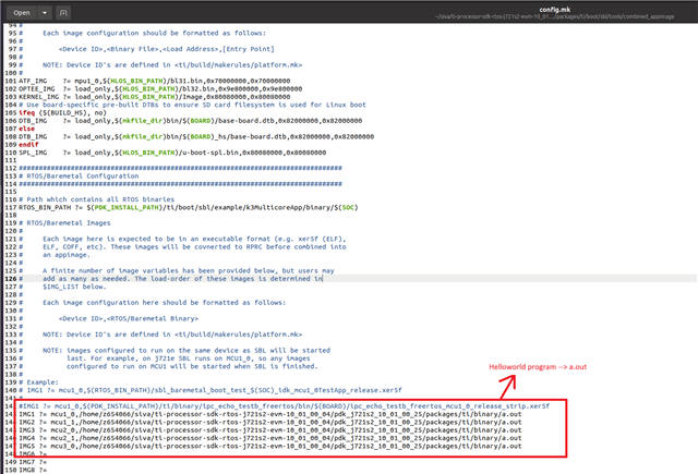

2.At  ti-processor-sdk-rtos-j721s2-evm-10_01_00_04\pdk_j721s2_10_01_00_25\packages\ti\boot\sbl\tools\combined_appimage, changed the file config.mk as per below screen shot
and changed the line from HLOS_BOOT ?= optimized to HLOS_BOOT = development

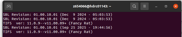

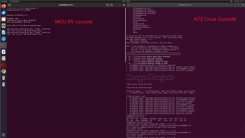

the j721s2 is not booting either the A72 Linux or helloworld program on MCU R5.
We were able to see only the TIFS related message on MCU R5 console as follows and no messages observed on A72 console.
Could you please help us in moving forward from here?
