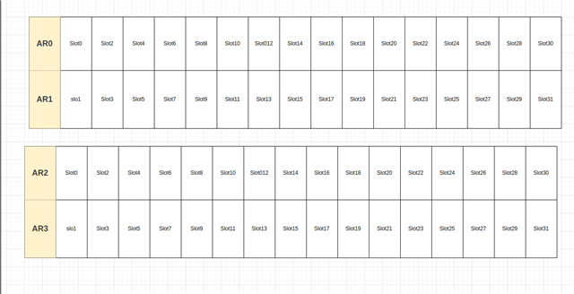

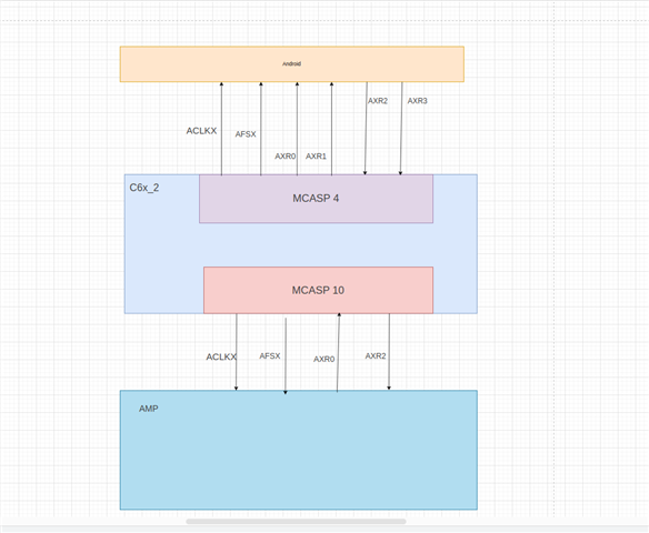

Hello expert Ti, I now have the following design for the audio:
The C6x_2 to Android uses TDM32, with a slot size of 32 bits:
The C6x_2 to AMP uses TDM32, with a slot size of 32 bits.
《Q1》:
Actually, the slot size transmitted from the AMP is 24 bits (effective data is 16 bits).
However, from what I've seen, I can directly receive it using int32_t, and the audio data is not distorted. (I saved it for later review.)
However, when I send int32_t data from the C6x_2 to the Android, the audio is distorted. Furthermore, when the Android sends audio data (slot size is 24 bits, effective data is 16 bits, and the C6x_2 receives it using int32_t) to the C6x_2, the audio is also distorted.
All MCASP configuration options are identical between MCASP 4 and MCASP 10, except for the MCASP_TXFMCTL.FXWID field. (MCASP 4 uses a single word; MCASP 10 uses a single bit.)
(Attached is my configuration file).

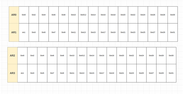

《Q2》:
Clock configuration for mcasp10:
Sync clock: 48 kHz
Bit clock: 32 * 32 * 48 kHz = 49152000 Hz
I tested two clock configurations for mcasp4:
Sync clock: 48 kHz
Bit clock_test1: 16 * 32 * 48 kHz = 24576000 Hz
Bit clock_test2: 32 * 32 * 48 kHz = 49152000 Hz
Which bit clock is correct in mcasp4?

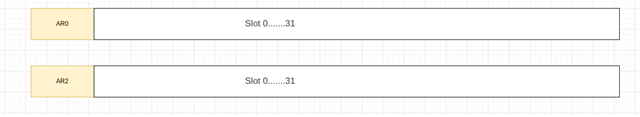

《Q3》:
In mcasp4, I only want to use a slot size of 32, so how do I configure bit padding and rotation?
Best Regards
Eason

  • Hi ,
    The bit clock should be: 'number of slots' * 'bits per slot' * 48 kHz
    You can control the padding and alignment of the slots using the MCASP_RXFMT and MCASP_TXFMT registers.
    You should use those registers to ensure that you are receiving the data in the correct format. Those registers also control the slot size.
    Jared
  • Hi Jared
    Thank you very much for your reply !
    I understand, but I still have a question:
    mcasp4 Under this design, the bit clock should be:
    16(number of slot ) * 32 ( bit per slot) * 48Khz = 24576000 hz , Right?
    I still have some questions about this response:
    The audio data transmitted by Android through AR2 and AR3 is of 16-bit signed type, and the slot size is 32 bits.
    And I hope to directly receive data of int32_t type in C6x_2:
    <Q1> How to set MCASP_RXFMT?(
    For example, symbol expansion)
    How to set MCASP_RXFMT.RROT ?
    How to set MCASP_RXFMT.RBUSEL ?
    How to set MCASP_RXFMT.RSSZ ? Slot size is 32 bit ? or 16 bit?

  • Hi ,
    I see what you're asking now. Since the 32 slots are split between two serializers, that should be correct.
