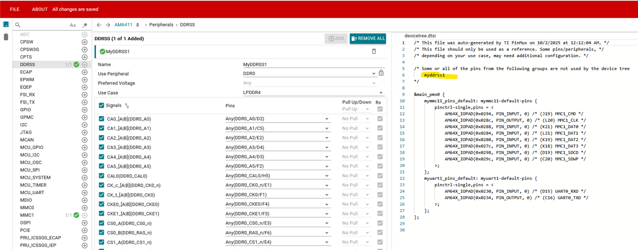

I was hoping to generate the dts file using the SysConfig tool, but I'm a bit confused about this.  Seems there are multiple ways to run the SysConfig tool.
(1) I don't seem to be able to configure the DDR memory here.
https://dev.ti.com/sysconfig

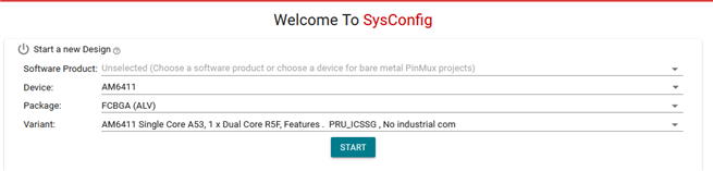

Note in this first method to run the SysConfig, I do not select a software product.  I've used this in the past to configure different hardware with AM6442 (with AM6442 selected instead).
But it seems I'm unable to get the ddr to actually configure?  Is this something I need to worry about?  I imagine I need to specify the size?

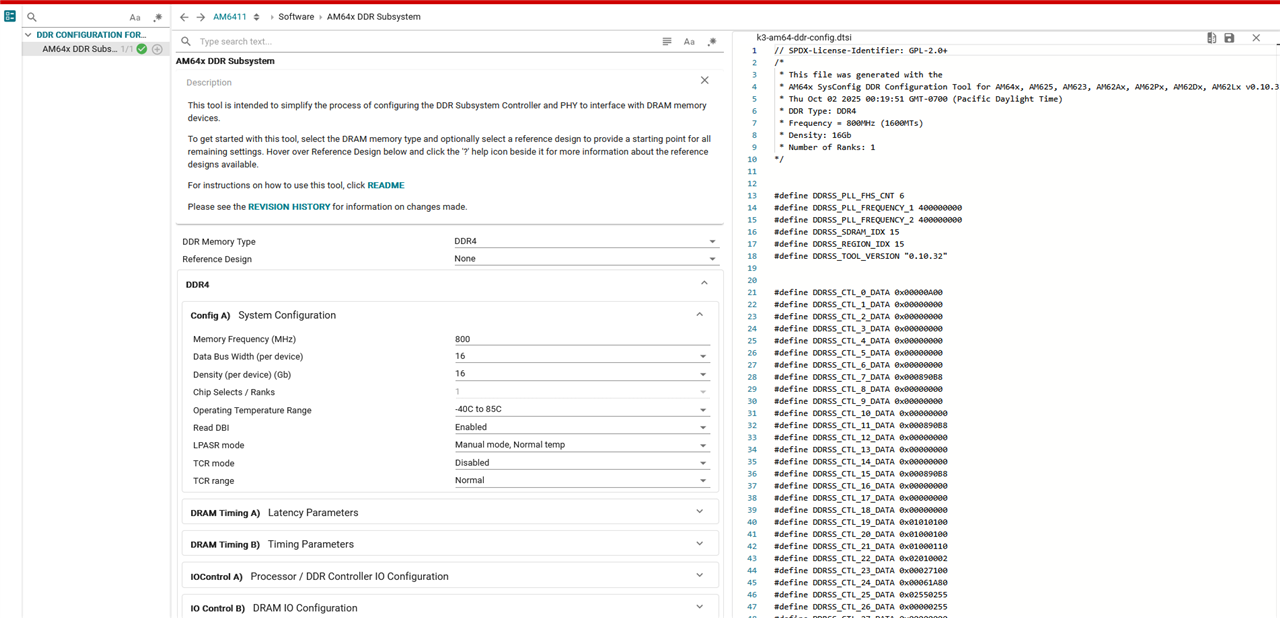

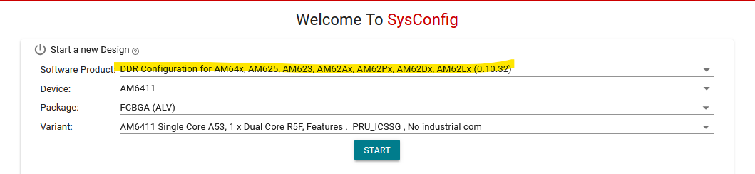

However, I see I can run this tool in a different fashion, with Software Product selected for DDR.
Now I get stuff for ddr config... how am I supposed to use this?  I see you link to the README: https://dev.ti.com/tirex/content/Processor_DDR_Config_0.10.32.0000/docs/README.html
However I think my memory may be the same from the AM6442 --> AM6411, so ideally I don't need to bother with this, but I'm confused a bit how running the SysConfig in these different methods should be used.
    Let's put the SysConfig tool aside for now. We will come back on it later if necessary.
    Do you mean you use the exact same DDR memory (type and size) as that the SK-AM62B EVM?
