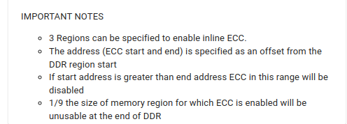

- enable/use inline ECC for ddr memory (and that's where we have a problem)

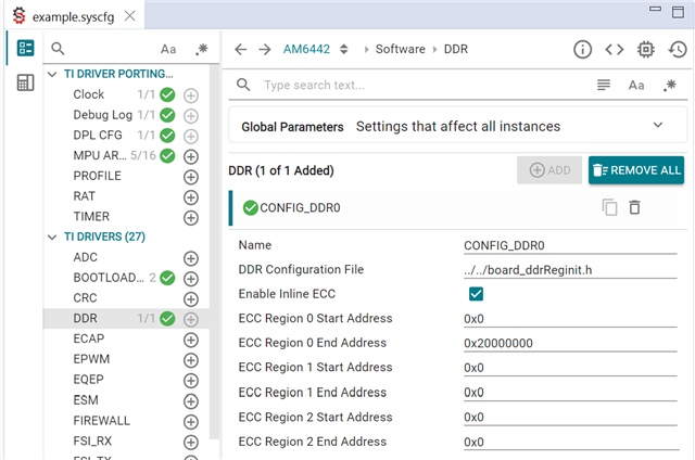

- R5 sbl:
  import and modify sbl_ospi_linux example into ccs
  Used proper lpddr init header from TI's ddr config tool (online sysconfig)
  According to docs, ddr should be configured here in sbl -> ddr: disable/enable ecc
- Multicore appimage:
  import empty project template from MCU SDK folder (just enable R5 cores, M4F: disabled, A53 removed, since we use linux)
  besides initialization, the code does nothing ( for(;;){} )
- modify u-boot (ti-processor-sdk_linux) so inline ECC is enabled (according to docs / make u-boot)
- create sdcard (use updated u-boot via make u-boot_install)
- call MCU_SDK\tools\boot\linuxAppimageGen to have the linux.appimage/u-boot.img files
- flash everything to OSPI via uart-uniflash sbl_ecc_ddr.cfg
The project: ecc_ddr_am64x.zip

observation: sd card seems to be ok, u-boot log reads ecc enabled, ram size is reduced since of ecc overhead

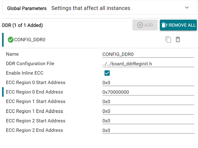

observation: ecc seems NOT to be active while u-boot(ing)
With ecc ENABLED, no ECC regions defined, the system becomes stuck right at "DRAM":

SoC:   AM64X SR2.0 HS-FS
Model: Texas Instruments AM642 SK
Board: AM64B-SKEVM rev A
DRAM:<stuck>
observation: boot process became stuck at DRAM: info.
With ecc ENABLED and ECC region defined, the system becomes also stuck right at "DRAM", too:
DMSC Firmware Version 11.0.7--v11.00.07 (Fancy Rat)
DMSC Firmware revision 0xb
DMSC ABI revision 4.0
KPI_DATA: [BOOTLOADER_PROFILE] CPU Clock        : 800.000 MHz
KPI_DATA: [BOOTLOADER_PROFILE] Boot Media       : NOR SPI FLASH
KPI_DATA: [BOOTLOADER_PROFILE] Boot Media Clock : 166.667 MHz
KPI_DATA: [BOOTLOADER_PROFILE] Boot Image Size  : 93 KB
KPI_DATA: [BOOTLOADER_PROFILE] Cores present    :
a530-0
r5f1-0
r5f1-1
r5f0-0
r5f0-1
KPI_DATA: [BOOTLOADER PROFILE] SYSFW init                       :      12750us
KPI_DATA: [BOOTLOADER PROFILE] System_init                      :    5020666us
KPI_DATA: [BOOTLOADER PROFILE] Drivers_open                     :       1790us
KPI_DATA: [BOOTLOADER PROFILE] Board_driversOpen                :     124745us
KPI_DATA: [BOOTLOADER PROFILE] Sciclient Get Version            :       9992us
KPI_DATA: [BOOTLOADER PROFILE] App_loadLinuxImages              :     254616us
KPI_DATA: [BOOTLOADER PROFILE] App_loadImages                   :      39688us
KPI_DATA: [BOOTLOADER PROFILE] CPU Load                         :          0us
KPI_DATA: [BOOTLOADER PROFILE] SBL End                          :          0us
KPI_DATA: [BOOTLOADER_PROFILE] SBL Total Time Taken             :      95542us
Image loading done, switching to application ...
Starting linux and RTOS/Baremetal applications
NOTICE:  BL31:E v2R.13.R0(rOeleasRe)::v2. 13.0-240B-gd90bb650fe-dirty
NOTICE:  BL31: Built : 21:37:18, Jun 23 2025
I/TC:
I/TC: OP-TEE version: 4.6.0-dev (gcc version 13.4.0 (GCC)) #1 Fri Apr 25 11:17:53 UTC 2025 aarch64
I/TC: WARNING: This OP-TEE configuration might be insecure!
I/TC: WARNING: Please check https://optee.readthedocs.io/en/latest/architecture/porting_guidelines.html
I/TC: Primary CPU initializing
I/TC: GIC redistributor base address not provided
I/TC: Assuming default GIC group status and modifier
I/TC: SYSFW ABI: 4.0 (firmware rev 0x000b '11.0.7--v11.00.07 (Fancy Rat)')
I/TC: Activated SA2UL device
I/TC: Enabled firewalls for SA2UL TRNG device
I/TC: SA2UL TRNG initialized
I/TC: SA2UL Drivers initialized
I/TC: HUK Initialized
I/TC: Primary CPU switching to normal world boot
U-Boot SPL 2025.01-gd2a72467939e-dirty (Oct 01 2025 - 16:39:24 +0200)
EEPROM not available at 0x50, trying to read at 0x51
Trying to boot from SPI
Authentication passed
U-Boot 2025.01-gd2a72467939e-dirty (Oct 01 2025 - 16:39:24 +0200)
DRAM:<stuck>
observation: boot process became stuck at DRAM: info. But initial boot time took significant longer, probably because of priming memory in R5 sbl?!
So my question is, how to properly enable inline ecc when booting from ospi in combination of linux?
I am also unsure, if I have used the proper files, when I created the linux.appimage from newly built u-boot.img for use in ospi-boot (config.mak was adjusted accordingly)?!
I used u-boot-spl.bin from this location: ti-processor-sdk-linux-am64xx-evm-11.01.05.03/board-support/u-boot-build/a53/spl. Is this correct?
kind regards, thorsten
