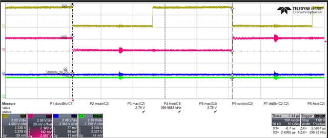

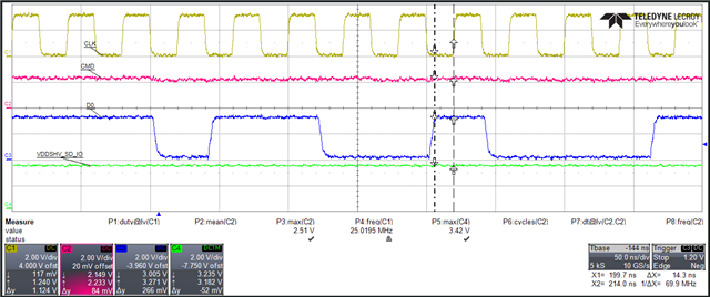

But many SD cards that don't boot fail at the 25MHz read, and the timing when it stops varies depending on the card.
It looks similar to Advisory i2462, but tiboot3.bin is successfully loaded.

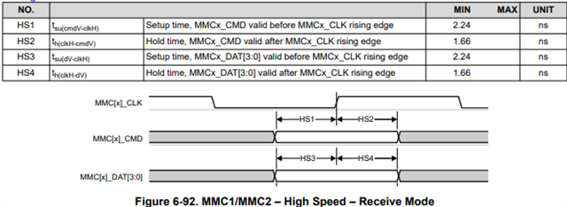

Our waveform measurements show that the setup/hold timing of the data/cmd and clock meets the requirements.
Question
- Has the SD card boot issue been resolved completely with SR1.1?
- When I check the waveform, the voltage levels of the CMD and Data signals are low, only about 2.1V even before switching to UHS-I.
Is this normal?
