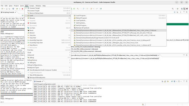

    I build the project using the make file system, and then loading the firmware from CCS i'm not able to debug because source code is not opened.
    Thanks.
    You should be able to see your application file after loading via CCS.
    Some files may not be as those will be parts of Libs created while packaging. If you perform clean build of libraries then you may able to see those files as well.
    Also, load normal image instead of strip image as strip image will not have debug symbols.

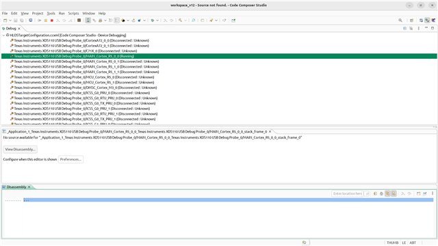

  • Hello Sudheer,
    I am not able see the source file. Here is step by step how i am doing,
    step 1 : I followed the userguide for build then i uploading the .out file in no boot mode
    not able to see the source code.getting error no source available. but i can able to see the disassembly

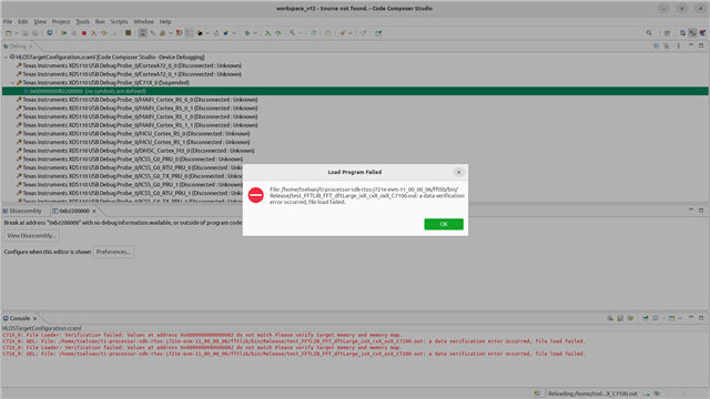

    step 2 : With OS
    I want to work with C7x but in this i am not even load the program
    So i tried different core here also i am not able to see the source code
    Where i am making mistake. can you clarify me?
    I could you are loading Release binary, which might have disabled debug symbols by default.
    Can you check with debug build and confirm?

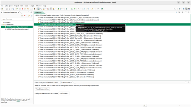

    step 2 : With OS
    What you mean by With OS?
    Is it a different boot mode? If so, can you please share more details how you are loading C7x here. It should be loaded via SBL in SBL boot mode, if using SPL boot flow then it should be loaded from u-boot or Linux?
    If you are not using no-boot mode, the C7x core should to be loaded by your boot loader and via debugger will just load symbols by connecting to core.
    Refer to debug with HLOS Running in CCS.
    https://software-dl.ti.com/jacinto7/esd/processor-sdk-rtos-jacinto7/11_01_00_04/exports/docs/psdk_rtos/docs/user_guide/ccs_setup_j721e.html#debugging-with-hlos-running-on-a72-linux-qnx
    Sudheer

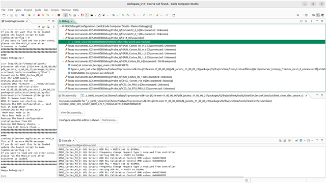

    and one more question, via CCS(with HLOS) loading the symbols , we need to choose our .out file or its different file.
    anyway i choosed our .out file because of my understanding this also contain the symbols.that time i got this error that is no symbols
    Tamilselvan P

    In SD card boot mode, while i create the softlink for c7x  and rebooted. the below is error log.
    Have you soft linked the same debug.out loaded above in No-boot mode or different one?
    Also, note that in case of SD boot mode, once core is loaded with the firmware and starts running. By the time when you connect the debugger and connect to the core it might have completed the execution of application.
    You can add a while loop at the beginning of application based on some global variable value, after connecting and loading the symbols to the core, update the variable and proceed further to run the code.
