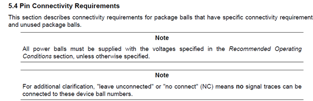

Hi   Dear  TI Experts,
Regarding the handling of unconnected signals that are not specified in the Pin Connectivity Requirements.
For the following unused signals, is an open-collector configuration sufficient, or do they require a pull-down resistor?
or VSS connection?

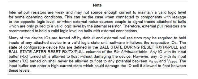

  • Hello KIYOSHI KOGURE
    Thank you for the query.
    Please refer below:
    Schematic Design guidelines and Schematics review checklist reference
    When a trace is connected to the processor pins (IO pads) and the IOs are not being actively driven (floating),
    a parallel pull 47kΩ is recommended. Processor IO buffers are (TX (Output) and RX (Input) are disabled during
    and after reset and internal pulls (pullup and pulldown)) turned off during reset and after reset. The IOs are in a
    high impedance state, effectively behaving as an antenna that can pick up noise. Without a parallel pull, the IOs
    are in high impedance state. High impedance makes noise to couple energy easily on the floating signal trace
    and develop a potential that can exceed the IO recommended operating conditions. The potential creates an
    electrical over-stress (EOS) on the IOs. Electrostatic discharge (ESD) protection circuits internal to the processor
    were designed to only protect the device from ESD during handling before being installed on a PCB.
    Processor Data sheet reference:
    reenivasa
