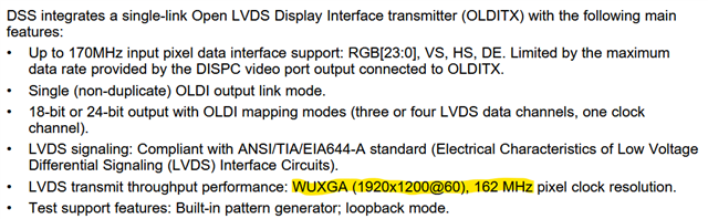

Thanks for your reply . I've clarified the customer's conditions more specifically to get simply "yes" or "no".
To minimize the pin resource, they asked us if AM625 can support 1920 x 1080 at 60fps with only single link OLDI or not. Would that be possible ?
I had checked this FAQ and TRM, the datasheet and application notes Although I believe that should be possible, I couldn't get the answer clearly so I posted this question to E2E for double-checking.

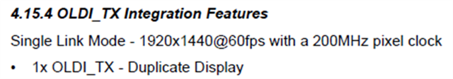

TRM mentioned as below but it seem pixel clock is higher than AM625 specification.

A single video port seems to be supporting single link as well as double link display interface.
I would expect the display resolution supported to be same between single link and double link.
As you may be aware, the OLDI x2 single link supports only mirror mode.

Hello Toshiaki Morita
I checked internally with the expert and received the below reply:
Yes it should be possible to support single link oldi for 1080p60 as i see oldi pll can go upto 1190 Mhz and for 1080p we usually require 148.5 * 7= 1039.5 Mhz
