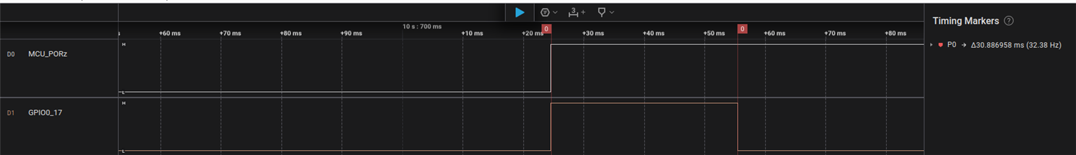

I want to achieve the fast boot in WKUP core and measured the corresponding time slots. The time measurement results is attached below.
Referring to your internal manual "Boot Time KPIs" for AM62P, the ROM boot time consumes 30ms and there is a huge gap between TI's measurements and our measurements. I want to know the reason about this and whether we could optimize the boot time KPI during ROM boot. The boot mode we use is OSPI.

  • Hi Meet,
    I have done the test on TI EVM and our measurement is about 73ms, based on the tutorial you provided above.
    The previous measurement on our custom board is about 79ms and the NOR FLASH we used on our custom board is S28HS512T, same as EVM.
    I also followed the method you have mentioned above and I attach the code for sbl_ospi_stage 1 below. I wonder whether I need some additional adjustments on Sysconfig. I would really appreciate if you could share your source code or binary for sbl_ospi_stage 1 and we could do the test on our EVM.
    BR,
    Bomiao

  • Hi Bomiao,
    The only difference I can observe is in the size of the image, I am using sbl_ospi_linux_stage1.release.tiimage having a size of 260kB, but I doubt that the difference in size will result into this big of a time difference, I am attaching my SBL OSPI Stage-1 image, you can test it at your end, and check if you observe the expected timing.
    sbl_ospi_linux_stage1.release.tiimage.zip
    Meet.
  • Hi Meet,
    I want to ask which pin you set low voltage at the SBL_start, is it as same as the tutorial mentioned (MCU_I2C0_SCL ;Pin #24 on the MCU Header J11) ? It also would be great if you could attach the whole project below.
    In addition to that, I noticed my image name is "sbl_ospi_linux_stage1.release.hs_fs.tiimage" and your image name is "sbl_ospi_linux_stage1.release.tiimage". Dose this means the secure boot effects the ROM boot time? If so, how to disable secure boot during ROM boot?
    BR,
    Bomiao
  • I want to ask which pin you set low voltage at the SBL_start, is it as same as the tutorial mentioned (MCU_I2C0_SCL ;Pin #24 on the MCU Header J11) ?
    Yes.
    Sure Please find it attached: sbl_ospi_linux_stage1.zip
    That was a mistake. I was supposed to attach hs_fs.tiimage itself.
