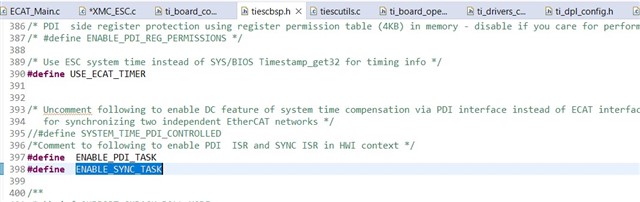

in the BSP, the Sync0 interrupt is triggered via a task (Sync0task()). With other interrupts in the system, the Sync0_ISR jitter is relatively strongly. There is a macro in the BSP:
The macro is also used in the source code of the BSP. How can customer change the Sync0_ISR to interrupt mode without changing the header in the SDK and having to rebuild parts of the SDK?
