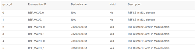

The rproc id that i have refered to is 4 for r5f1_0
Is there any changes to be done.
How do I proceed further to use the shared memory between A53 and remote core

    Hello Mamatha,
    Hmm. It looks like function "dmabuf_heap_alloc" is forming rproc_name by taking rproc_id and putting it at the end of "/dev/remoteproc%d"
    https://git.ti.com/cgit/rpmsg/rpmsg_char_zerocopy/tree/linux/src/rpmsg_char_zerocopy.c
    /* Allocate dma-buf from dma-heap, mmap locally, get the phys address
     * and setup the buffer data we want to pass to the remote endpoint
     * in ipc_buf and the local data we want to keep in local_buf.
    int dmabuf_heap_alloc(int rproc_id, int dma_heap_fd, int size,
    		       struct local_buf *lbuf,
    		       struct ipc_buf *ibuf)
    	sprintf(rproc_name, "/dev/remoteproc%d", rproc_id);
    	rproc_fd = open(rproc_name, O_RDONLY | O_CLOEXEC);
    	if (rproc_fd < 0) {
    		printf("Failed to open %s: -%d\n", rproc_name, errno);
    		return -1;
    But that is not how the code should run, because rproc_id is a fixed value for each core. On the other hand, /dev/remoteprocX is not a fixed value. The X value is assigned by order of which core gets initialized first, which means that which core is associated with a specific remoteprocX number can actually change on each boot.
    We can look at function _rpmsg_char_find_rproc() as a reference. rproc_id is used to find the correct remoteprocX instance, and it sets ept->remoteproc_id == X.
    https://git.ti.com/cgit/rpmsg/ti-rpmsg-char/tree/src/rpmsg_char.c
    Please try to modify rpmsg_char_zerocopy > dmabuf_heap_alloc to look like _rpmsg_char_find_rproc(). Please let me know if this works, if so I will update the zerocopy project with the new code.
    Nick
