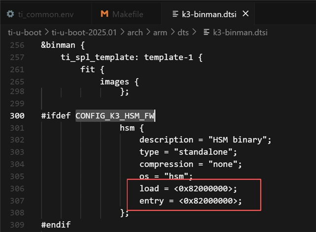

Hi Expert,
1. From below guide, this address is for J721E, and it missed the ramdisk load address as well;
3.2.1. Users Guide — Linux SDK for AM62L Documentation
2. I can find the load address from uboot env file, but I can't find the document to support this.
3. the kernel image load address is conflict with hsm load address.
So I want to double confirm with you, should I follow the load address list in uboot env file? can you give me some update document about this?
