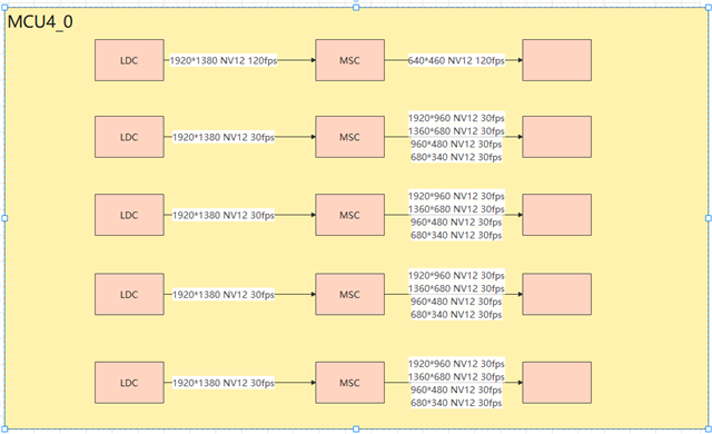

hi ti experts:
In MCU4_0, five msc channels are used.
One of the channels has an input of 1920*1380 NV12 at 120fps and an output of 640*460 NV12 at 120fps, with the vpacDrvInstId being VHWA_M2M_VPAC_1_MSC_DRV_INST_ID_0.
The other four channels have an input of 1920*1380 NV12 at 30fps and outputs of 1920*960, 1360*680, 960*480, and 680*340 NV12 at 30fps, with the vpacDrvInstId being VHWA_M2M_VPAC_1_MSC_DRV_INST_ID_1.
In the above case, the following error will be reported continuously after running for 7-8 frames:
src/drv/vhwa_m2mMscUdma.c @ Line 855:
UDMA Output Ring dequeue failed for ch0!!
src/drv/vhwa_m2mMscUdma.c @ Line 846:
UDMA Output Ring dequeue mismatch for ch0!!
After less than 1 second, the following error occurred and the user task was blocked
src/drv/vhwa_m2mMscUdma.c @ Line 585:
Ring queue failed retVal:-1
src/drv/vhwa_m2mMscIntr.c @ Line 630:
ISR0 Submiit request failed
 RE: TDA4VM: UDMA Output Ring dequeue mismatch for ch0
We have referred to other issues and the bug has been fixed in 11.0, but the problem still exists
