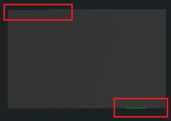

Hello Team,
We are using gstreamer pipeline to  capturing image at 512x320 resolution using v4l2jpegenc.
In that, we are getting black and green line in images.
In below my thread fixed mentioned by @
https://e2e.ti.com/support/processors-group/processors/f/processors-forum/1408954/sk-am62a-lp-limitation-of-resolution-with-v4l2jpegenc/5520676?tisearch=e2e-sitesearch&keymatch=%25252525252520user%2525252525253A599112#
Hello Jaimin,
You'll need the firmware builder because the fix involved imaging source code change.
I want to know which changes fixed in firmware builder.
Does only  provided patch will be sufficient for fixed or we required firmware builder patch as well ? if yes can you please provide firmware builder patch ?
We have the firmware builder setup.
Apply this patch to /opt/edgeai-gst-plugins: https://github.com/TexasInstruments/edgeai-gst-plugins/commit/a6db8dd7931b15290235f33265052ef51848e338
