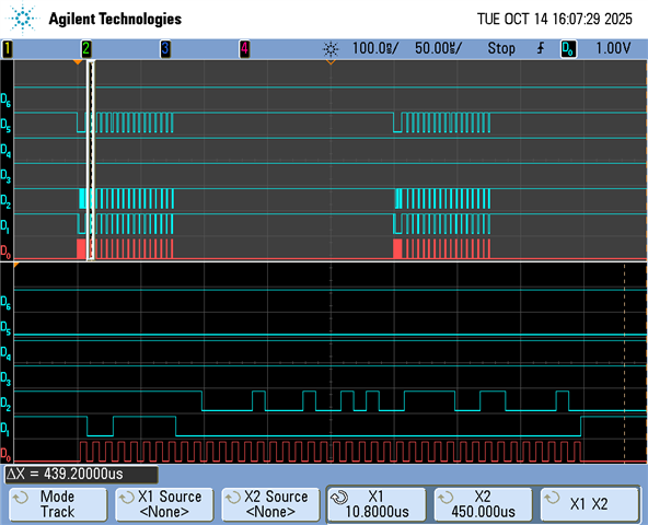

Upon detailed investigation of a brand new board, I find that the QSPI boot mode never sends any read commands to get data from the flash. Per the AM62D TRM, the boot ROM should send a 0x6B (QREAD) command using 3-byte addressing followed by 8 dummy cycles. Per the flash datasheet, this command sequence is supported.
Here is the flash signal mapping for the following scope captures:

Here are the initial transactions on the QSPI interface upon release of MCU_PORz:
Each burst consists of 17 JEDEC ID reads (command 0x9F, RDID): 1 with SCLK=6.25MHz and 16 with SCLK=50MHz. The boot ROM never issues any read commands to the flash.
