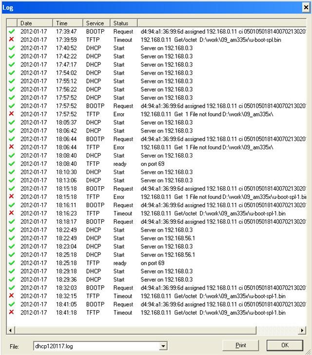

1) When I powered up the board with sysboot[4:0] set to 01011b, my Windows host PC prompt me for the "SUBARCTIC" device driver. Where I can download this (RNDIS) driver ? or the INF file ?
2) Do I need a TFTP server running on my host PC ?
3) How does the TFTP client in the boot ROM get to know the IP address of the host PC ?
4) What is the file name that the TFTP client will request to download from the host PC ?
5) Does TI have any user guide/ app note/ flashing tools on Booting from USB0 ?

    What you suggest should be possible. I am a bit confused why you are looking for a Windows RNDIS driver when you say that you are using a Linux SDK? Are you running this inside VMWare or similar? If so it may be easier to forward the USB port to the virtual machine when you plug the device in so that Linux can use its RNDIS driver. I understand that the USB boot mode uses RNDIS and apart from using the USB, this is just like Ethernet boot at a higher level. This requires a DHCP/BOOTP server and a TFTP server. The EVM IP address (and TFPT filename?) would be obtained from BOOTP. The boot loader would then be fetched via TFTP. The EVM Linux setup already includes a TFTP server.I'm not sure there's enough space to load U-Boot in this first stage so you may need to load the TI X-Loader which has been configured to load U-Boot via RNDIS. U-Boot would then do a have to do a TFTP kernel boot via RNDIS too. I think U-Boot can be persuaded to write flash images?

  • Hi Roger, Cyril,
    Thanks very much for the clear and detail explanation on how usb booting works.
    I managed to get the RNDIS driver installed on my Windows PC, and assigned a fix IP like 192.168.0.3 to it.
    Also, the hane DHCP server was setup as per suggested.
    However, the DHCP server seems to miss the DHCP/BOOTP request most of the times. At instances where the server manage to serve the request, the TFTP transfer will subsequently failed with timeout error as shown in screen below.
    So far I have no luck to get the TFTP transfer completed successfully. Wondering if you have managed to get it work before?

  • Hi  Thomas,
    I'am at the same step. I think we need to upload a small MLO file first. Then this file ask for the rest of the u-boot. But I have to work on this topic.
    Cyril
  • Hi Cyril,
    I've also tried MLO, but still get the same timeout error.
    I wish you success in using usb to download the MLO, u-boot, kernel all the way to rootfs and hopefully share the experience with us in future.
    Good luck & Thanks.
    - Thomas

  • Please refer to the following thread that explains current USB boot issues with revision 1.0 of the AM335x device:
    http://e2e.ti.com/support/dsp/sitara_arm174_microprocessors/f/791/t/168595.aspx?pi69149=2
    Additionally, the root cause is described in the AM335x Device Errata (SPRC360Z).
