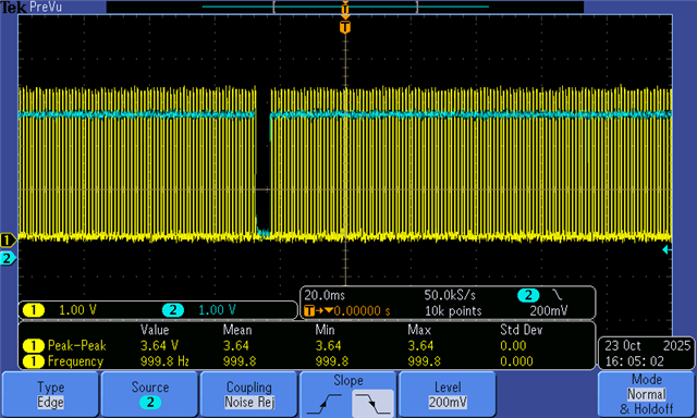

  • Dear Anxiao.
    it needs call SOC_allowEpwmTzReg() to unlock the access(write) to TZ register.
    please apply below patch to epwm_duty_cycle demo in MCU+ SDK.
    step1: preapre one SD card, copy epwm_duty_cycle demo binary with patch applied.
    step2: probe AM620 ball A13 and B14. and use a cable to connect B14 to 3.3V power rail by default.
    step3: power on the board. check there is PWM wave on ball A13.
    step4: plug out and plug in the cable quickly. check there is no PWM wave output when ball B14 is low.
    https://e2e.ti.com/cfs-file/__key/communityserver-discussions-components-files/791/0001_2D00_am62x_2D00_enable_2D00_ePWM_2D00_CBC_2D00_TZ_2D00_not_2D00_enable_2D00_TZ_2D00_INT.patch
    thanks a lot!
    yong
