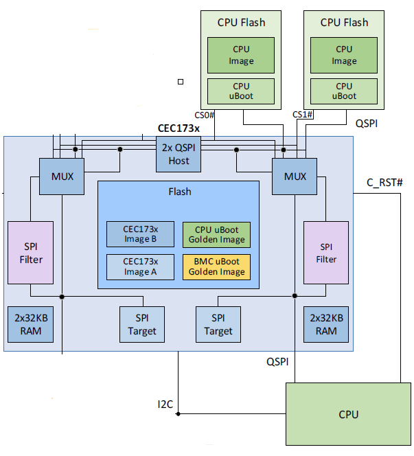

  • Hi, RonB:
        Are there any solutions for using eROT (OCP SPDM Profile and OCP Attestation v1.1 SPDM) on the AM62x, such as CEC1736?
    I don't know of any canned solutions with this configuration.
    Taking a look at the CEC173x device, it seems to provide an OSPI interface and the AM62x can boot from OSPI. If the interface is compliant with what AM62x supports, this should work.
    Ron
  • Hi, RonB:
        AM62x does not support dual QSPI boot. This application scenario is that when the QSPI Flash of CS0 fails to boot, the CPU will try to boot from the QSPI Flash of CS1. The same applies to the CEC1736, which safely manages two QSPI Flashes. If there is a problem with CS0, it will switch to the QSPI Flash of CS1.
  • Louis,
    Update my findings:
    I browsed CEC173x datasheet, did not find the requirement of second QSPI_CS1 as backup. authentication is handled by CEC173x before release AP from reset, backup image can be configured by CEC173x. So I didn't see QSPI_CS1 as backup boot storage is necessary.
    Please correct me if wrong.
