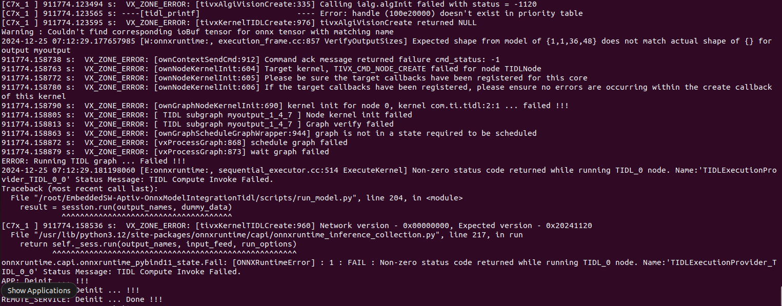

I have a model with a gridsample node. I want to run it on the board.
I'm using sdk 10.1 with runtime version 1.15.0
When I run this model on the board, I have the error of graph verify failed:
As you can see also the output shape is empty.
I used 2 different models for this test and I've got the same error.
here is the 2 models:
Could you help analyze possible causes for this “Graph Verify Failed” error.
Do you have any suggestion to fix this issue?

  • Hello Christina,
    Thank you for your reply.
    I tried another model with add node after the gridsample node and I have these results:
    On PC: inference is running
    On board: I have this error
    Here is the model: 8738.gridsample_model.zip

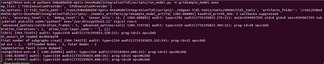

  • Hello Christina,
    I'm using edgeai-tidl-tools version 10_00_06_00.
    Here is the configuration used during the compilation.

    And here is the model compilation log:
    root@04543ce51ffc:/home/root# python3 scripts/run_model.py -m gridsample_model.onnx -c
    ep_list: ['TIDLCompilationProvider', 'CPUExecutionProvider']
    ep_options: [{'tidl_tools_path': '/home/root/scripts/../edgeai-tidl-tools/tools/AM69A/tidl_tools', 'artifacts_folder': '/home/root/scripts/../models_artifacts/gridsample_model_artifacts', 'accuracy_level': 1, 'debug_level': 4, 'tensor_bits': 16, 'advanced_options:calibration_frames': 1, 'advanced_options:calibration_iterations': 1, 'allow_list:layer_name': ''}, {}]

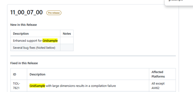

    Thanks for sending this over. Are you able to upgrade your SDK/TIDL TOOLS version? We had a couple of issues fixed for Gridsample from our 11.0 release, including one that could be related to the issue you might be seeing.
    I will work on verifying if this fix is what you need, but wanted to make sure if you could upgrade as well.

  • Hi Ghassen,
    I am checking internally on the backport but could you verify which SDK version you are using, as well as which edgeai-tidl-tools version you are using?
    You mentioned here that you are using 10.1 SDK
    sdk 10.1
    whereas for the edgeai-tidl-tools, you are using 10_00_06_00
    10.00.06.00 edgeai-tidl-tools will not work on SDK 10.1, which may be why you are seeing an issue when running on board if this is the case.
    If you are using SDK 10.1, then you can use edgeai-tidl-tools version 11_00_07_00 which is the backport compatible for this SDK.
    You can check the versions that match with the SDK version on the compatibility table found here: https://github.com/TexasInstruments/edgeai-tidl-tools/blob/master/docs/version_compatibility_table.md
    Warm regards,

  • Hi Ghassen,
    thank you for the clarification! In this case, I recommend using 11_00_07_00  since this is backport compatible and see if this has the necessary gridsample bug fixes.
