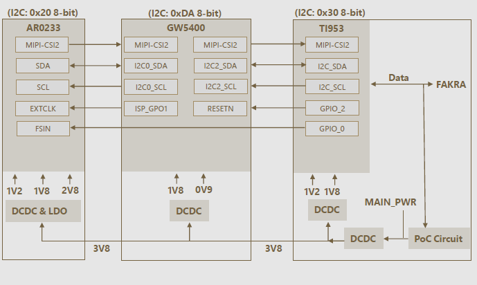

Hi all,
i am currently integrating LI-AR0233-GW5400-FPDKINKIII camera with inbuilt ISP in TDA4VH platform . This imager gives YUV422 8 bit output and the block digram of this imager  given below
While trying to integrate this imager ,we used the same sensor driver for AR0233 and made below changes

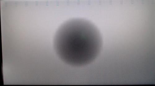

After this changes when i am running the single cam application ,i am getting sensor detected as " UB9xxx_RAW12_TESTPATTERN" . and getting a test pattern output in the display.
Other than above changes, do i need to make any other changes in the sensor driver? Can you please support on this issue.

  • Hi Ajay,
    It looks like you only made 2 lines of changes on the driver for AR0233 raw image sensor.
    I doubt if that would work well.
    You may take a look at another old drive we had for AR0233 YUV sensor in this link and compare it to the AR0233 raw sensor driver.
    The YUV driver is outdated by now as we don't have any GW cameras, but you should be able to see the difference between a YUV sensor driver and raw sensor driver.
