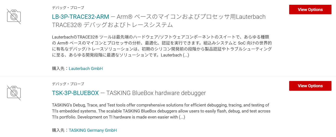

Hello experts,
Which debuggers are supported for TDA4APE4 during development?
My understanding is following debuggers are supported. Are there any other debuggers?
What is the difference between these debuggers? Is there any material I can refer to?
    Multiple debug tools can work with TDA4APE.  The Lauterbach-TRACE32 and Tasking-Bluebox listed are highly featured tools which offer features like advanced trace and timing analysis.  I am aware of multiple customers using these two tools.
    What is sufficient depends on your requirements.  TI debugger is commonly used.  Setups will have lower costs but also not all the same features.  https://www.ti.com/design-development/embedded-development/arm-based-processors.html#partners
    For very basic and ~free even OpenOCD can work.  Other vendors like GreenHills, Segger, ... provide support for TDA4 processors. I'm unsure if they have a package for this exact chip, but as chips in the family are similar they could add it upon request.   If you have a preferred tool, you should ask the vendor.  I am aware of customers using a wide variety of solutions (especially on the ARM processors).
