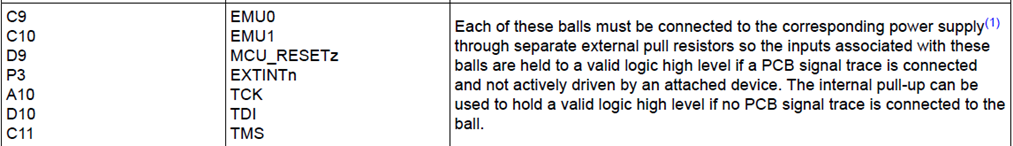

Hello experts,
For the MCU_RESETz, refer to section 5.4 of the datasheet for DSP-side terminal processing.
The power supply is shown to be PU, but the same is not shown in EVM schematic. Do I need a PU?
