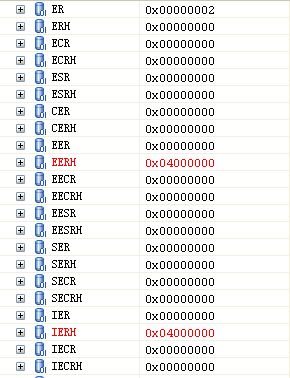

While debugging my project ,I find that I can run into the ISR function of the HWI_11,
but there is no event appear in the ER/ERH register(I have enabled the event );
besides, if I mannually trigger the EDMA,the EDMA can work well.
if anybody has the same problem, thank you for your reply!

  • After config the EDMA,I check the EDMA3CC register, I find that :
    And this mean the event of GPIO10 have been enabled.while I have detect the GPIO10 interrupt,the register of ERH does not change

    As I explained above, with the EERH bit set, the ERH bit will not stay set long enough to see it.
    Please clear the EERH bit for this test, and see if the ERH bit does get set after that.
    If ERH does not get set, then there is another configuration issue between the GPIO and the EDMA.
