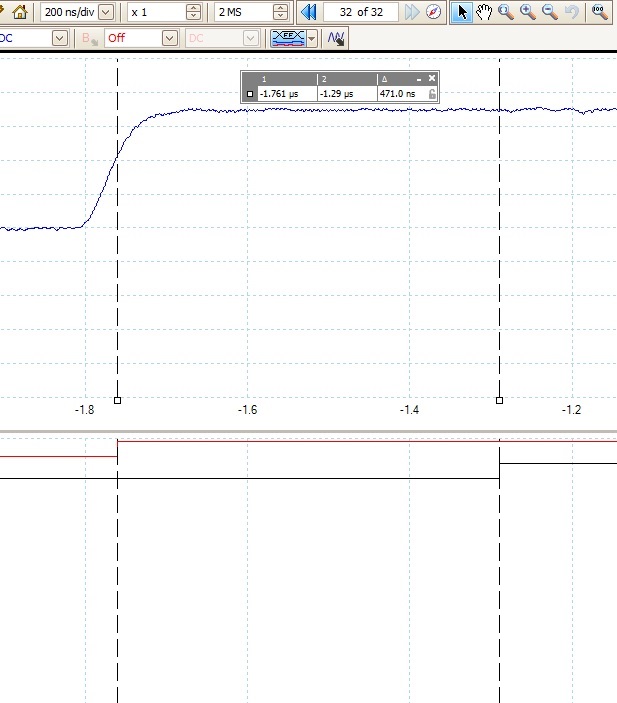

Hello everyone I am currently monitoring the effect of a GPIO interrupt latency with a scope by raising the XF pin in the interrupt routine.
So far I have measured around 600 ns from the raising edge of the input signal onto the GPIO and to the first line of code inside the routine.
I am aware of the automatic context savings but I can't think of any solution to lower this latency.
For what I know, jumping to the routine via vectors shouldn't take more than few cycles (around 50 ns I guess), saving context shouldn't take more than 20 cycles(only few registers to save). So I was aiming at something at around 100 ns to get to the first line of my routine.
Have you got any idea of how I can lower this latency?

  • Hello Mark and thanks for you time.
    I am running a 5515 dsp at a speed clock of 98MHz
    Memory is set to huge and the XF is raised via the asm("   bset XF") command.
    interrupt void GPIO_isr(void)
    asm(" BIT (ST1, #ST1_XF) = #1");
    I am using the fast return mode and no other interrupts are active.
    The only thing I haven't thought about is the small memory model. How does it affect the timing ?
    I don't really how to optimize this part of the program as it's all done in hardware with vectors and stuff.
    I put a screen capture attached to this email from my mixed signal scope.
    I am really forward to hear from you again.
    Many thanks
  • You might try writing your interrupt routines in C55x assembly instead of C.
    The C compiler is very smart about context saving, but if you call a C subroutine within your interrupt function then the context on the stack will necessarily be significantly larger. I learned a great deal by looking at the assembly output generated by the C compiler as I modified my code. I was able to use macros and other compile-time code generation to avoid subroutines, which significantly sped up my C language interrupts. For some interrupts, though, I decided to use assembly for minimum cycle counts.
    You should also look into the available #pragma hints that you can use to tell the compiler more about how your C language subroutines will be used.
    Note that I have over 6 million DMA operations per second on a C5506, which is more than one DMA transfer every 27 cycles. My interrupts are designed to occur much less frequently than the DMA, but I still found that I needed to minimize the cycles wasted by context saving that were really only needed due to the convenience of the C language and an initial lack of understanding of the consequences of simple design paradigms.
  • thanks for your reply.
    Indeed I've got very different result with subroutines in the ISR. Even though they are a couple of cycles, it changes everything for the registers and the stack.
    I will definitely look at how the compiler behave into the generated asm files.
    Thanks a lot for your help
    ps: I found out that GPIO interrupt are slow by definition. I use a timer instead. It is much better now.
