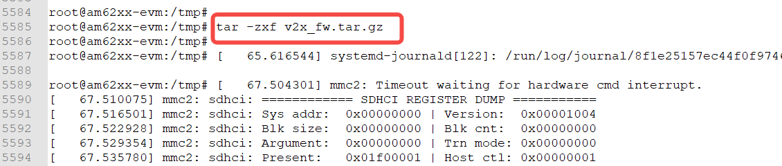

Scenario 1: Decompression crash
  • ‪D:\uid00909\Downloads\解压crash.txt
  • Hi Xiading,
    could you please give more details about the activity that you are trying to achieve? so that i can redirect you to the expert
    Dilna K
  • please upload full kernel log.
  • And also, Xiaoding, what is the MMC2 now, a SD card? How about the status of write protect pin detect and is it a read/write file sytem now or read only??
  • eMMC is MMC0, what should the status of other MMCs be?
    Yes, after entering the system, executing tar -zxf v2x_fw.tar.gz in the /app or /tmp directory will cause a crash.

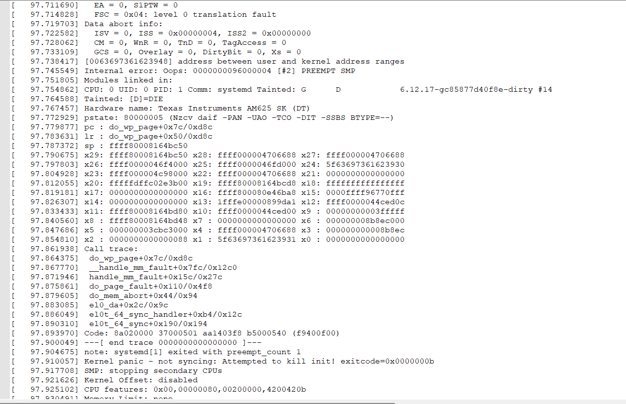

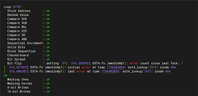

  • Scenario 2: Running the test program causes a system crash.

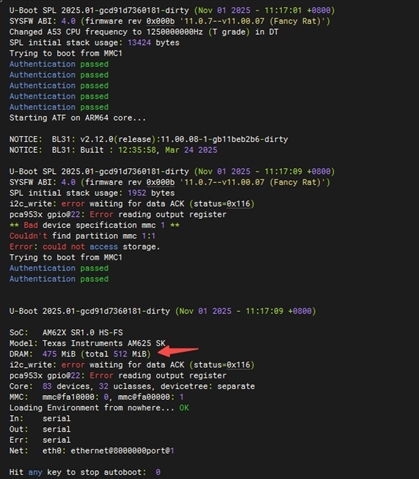

    U-Boot 2025.01-gcd91d7360181-dirty (Aug 23 2025 - 14:48:44 +0800)
    SoC:   AM62X SR1.0 HS-FS
    Model: Texas Instruments AM625 SK
    DRAM:  2 GiB
    i2c_write: error waiting for data ACK (status=0x116)
    pca953x gpio@22: Error reading output register
    Core:  83 devices, 32 uclasses, devicetree: separate
    MMC:   mmc@fa10000: 0, mmc@fa00000: 1
    Loading Environment from nowhere... OK
    In:    serial
    Out:   serial
    Err:   serial
    Net:   eth0: ethernet@8000000port@1
    Hit any key to stop autoboot:  0
    switch to partitions #0, OK
    mmc0(part 0) is current device
    SD/MMC found on device 0
    Can't set block device
    22258176 bytes read in 127 ms (167.1 MiB/s)
    61652 bytes read in 3 ms (19.6 MiB/s)
    Working FDT set to 88000000
    ## Flattened Device Tree blob at 88000000
       Booting using the fdt blob at 0x88000000
       Loading Device Tree to 000000008feed000, end 000000008fffffff ... OK
    Working FDT set to 8feed000
    Starting kernel ...
    [    0.000000] Booting Linux on physical CPU 0x0000000000 [0x410fd034]
    [    0.000000] Linux version 6.12.17-g505d6c2c6f8f-dirty (uid00909@hzh46167u) (aarch64-oe-linux-gcc (GCC) 13.3.0, GNU ld (GNU Binutils) 2.42.0.20240723) #57 SMP PREEMPT Fri Sep 12 17:13:35 CST 2025
    [    0.000000] KASLR disabled due to lack of seed
    [    0.000000] Machine model: Texas Instruments AM625 SK
    [    0.000000] earlycon: ns16550a0 at MMIO32 0x0000000002800000 (options '')
    [    0.000000] printk: legacy bootconsole [ns16550a0] enabled
    [    0.000000] efi: UEFI not found.
    [    0.000000] Reserved memory: created CMA memory pool at 0x00000000f8000000, size 128 MiB
    [    0.000000] OF: reserved mem: initialized node linux,cma, compatible id shared-dma-pool
    [    0.000000] OF: reserved mem: 0x00000000f8000000..0x00000000ffffffff (131072 KiB) map reusable linux,cma
    [    0.000000] OF: reserved mem: 0x000000009e800000..0x000000009fffffff (24576 KiB) nomap non-reusable optee@9e800000
    [    0.000000] OF: reserved mem: 0x0000000080000000..0x000000008007ffff (512 KiB) nomap non-reusable tfa@80000000
    [    0.000000] OF: reserved mem: 0x000000009c700000..0x000000009c7fffff (1024 KiB) map non-reusable ramoops@9c700000
    [    0.000000] Reserved memory: created DMA memory pool at 0x000000009c800000, size 3 MiB
    [    0.000000] OF: reserved mem: initialized node ipc-memories@9c800000, compatible id shared-dma-pool
    [    0.000000] OF: reserved mem: 0x000000009c800000..0x000000009cafffff (3072 KiB) nomap non-reusable ipc-memories@9c800000
    [    0.000000] Reserved memory: created DMA memory pool at 0x000000009cb00000, size 1 MiB
    [    0.000000] OF: reserved mem: initialized node m4f-dma-memory@9cb00000, compatible id shared-dma-pool
    [    0.000000] OF: reserved mem: 0x000000009cb00000..0x000000009cbfffff (1024 KiB) nomap non-reusable m4f-dma-memory@9cb00000
    [    0.000000] Reserved memory: created DMA memory pool at 0x000000009cc00000, size 14 MiB

    root@am62xx-evm:~# [  216.027923] Unable to handle kernel NULL pointer dereference at virtual address 0000000000000038
    [  216.036786] Mem abort info:
    [  216.036976] ------------[ cut here ]------------
    [  216.039584]   ESR = 0x0000000096000004
    [  216.044186] WARNING: CPU: 3 PID: 117 at mm/slub.c:4711 free_large_kmalloc+0xac/0xe0
    [  216.047967]   EC = 0x25: DABT (current EL), IL = 32 bits
    [  216.055584] Modules linked in:
    [  216.060882]   SET = 0, FnV = 0
    [  216.060881]

  • 4r-unpack-crash.txt After disabling MMC logging, decompression in another directory caused a crash
  • suspect to lack of proper kernel and/or high memory to decompress a relatively large tar.gz file on the AM6204's board with limited DDR memory, please consider accordingly and wait for BU's expert for further comments. thanks.

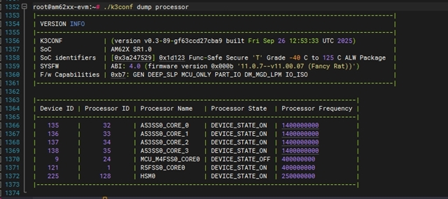

  • Hi Xiaoding,
    Thanks for cleaning up the log, the new one (4r-unpack-crash.txt) is much cleaner!
    In this log, there is no MMC related messages when the "NULL pointer dereference" problem happens while untar the file, so the issue is unlikely related to eMMC, but typically about stability in CPU, power supplies or DDR.
    First please run command 'k3conf dump processor' to check the A53 clock, to see if it is correct speed for the AM625x device you use.

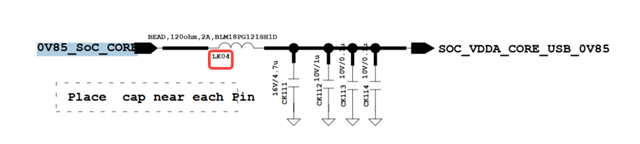

    Then probe all the power rails to see if they are all in valid ranges defined in the AM62x datasheet.
    If the CPU or power rails look good, let's check the DDR, please first run command 'memtester 16M 10' to see if the test reports any DDR issue.

    [   54.521775] Internal error: Oops: 0000000096000005 [#1] PREEMPT SMP
    [   54.521781] Modules linked in:
    [   54.521789] CPU: 3 UID: 0 PID: 11 Comm: kworker/u16:0 Not tainted 6.12.17-gc85877d40f8e-dirty #17
    [   54.521796] Hardware name: Texas Instruments AM625 SK (DT)
    [   54.521800] Workqueue: events_unbound call_usermodehelper_exec_work
    [   54.521822] pstate: 400000c5 (nZcv daIF -PAN -UAO -TCO -DIT -SSBS BTYPE=--)
    [   54.521828] pc : __lruvec_stat_mod_folio+0x50/0xe4
    [   54.521838] lr : __lruvec_stat_mod_folio+0x24/0xe4
    [   54.521844] sp : ffff800081743b30
    [   54.521847] x29: ffff800081743b30 x28: ffff000003fe1680 x27: ffff00000673b180
    [   54.521857] x26: 0000000000808100 x25: ffff800081511620 x24: ffff0000005a3180
    [   54.521866] x23: 0000000000000000 x22: ffff000003fe1680 x21: fffffdffc022bfc0
    [   54.521876] x20: 0000000000000025 x19: 0000000000000004 x18: 0000000000000000
    [   54.521886] x17: 0000000000000000 x16: 0000000000000000 x15: 0000000000000000
    [   54.521895] x14: 0000000000000000 x13: 0000000000000000 x12: 0000000000000000
    [   54.521905] x11: 0000000000000000 x10: 0000000000000000 x9 : 0000000000000000
    [   54.521914] x8 : ffff800082e4c000 x7 : 0000000000000000 x6 : 000000000000003f
    [   54.521924] x5 : 0000000000000040 x4 : 00000000000133c3 x3 : 0000000000000000
    [   54.521933] x2 : 0000000000000004 x1 : 00000000000133f8 x0 : ffff8000814f0480
    [   54.521943] Call trace:
    [   54.521948]  __lruvec_stat_mod_folio+0x50/0xe4
    [   54.521955]  account_kernel_stack.isra.0+0x4c/0x70
    [   54.521966]  copy_process+0x20c/0x13d8
    [   54.521974]  kernel_clone+0x68/0x368
    [   54.521982]  user_mode_thread+0x70/0xa4
    [   54.521990]  call_usermodehelper_exec_work+0x7c/0xa8
    [   54.521998]  process_one_work+0x148/0x28c
    [   54.522007]  worker_thread+0x2d0/0x3d8
    [   54.522015]  kthread+0x110/0x114
    [   54.522025]  ret_from_fork+0x10/0x20
    [   54.522039] Code: f0009340 91120000 b99a7003 8b030c21 (f9434435)
    [   54.522044] ---[ end trace 0000000000000000 ]---

    [   54.522275]  worker_thread+0x2d0/0x3d8
    [   54.522284]  kthread+0x110/0x114
    [   54.522291]  ret_from_fork+0x10/0x20
    [   54.522299] Code: 54000c00 f9400260 d1002002 a9400403 (f9000461)
    [   54.522303] ---[ end trace 0000000000000000 ]---
    [   54.522307] note: kworker/u16:1[38] exited with preempt_count 2
    [   54.522694] Call trace:
    [   54.522697]  free_large_kmalloc+0xac/0xe0
    [   54.525542] Unable to handle kernel paging request at virtual address 000000000005cc3d
    [   54.525560] Mem abort info:
    [   54.525562]   ESR = 0x0000000096000006
    [   54.525565]   EC = 0x25: DABT (current EL), IL = 32 bits
    [   54.525569]   SET = 0, FnV = 0
    [   54.525572]   EA = 0, S1PTW = 0
    [   54.525574]   FSC = 0x06: level 2 translation fault
    [   54.525578] Data abort info:
    [   54.525581]   ISV = 0, ISS = 0x00000006, ISS2 = 0x00000000
    [   54.525584]   CM = 0, WnR = 0, TnD = 0, TagAccess = 0
    [   54.525588]   GCS = 0, Overlay = 0, DirtyBit = 0, Xs = 0
    [   54.525592] user pgtable: 4k pages, 48-bit VAs, pgdp=00000000846db000
    [   54.525597] [000000000005cc3d] pgd=0800000081df2003, p4d=0800000081df2003, pud=0800000081d16003, pmd=0000000000000000
    [   54.525614] Internal error: Oops: 0000000096000006 [#3] PREEMPT SMP
    [   54.525619] Modules linked in:
    [   54.525630] CPU: 1 UID: 0 PID: 473 Comm: kworker/u16:4 Tainted: G      D            6.12.17-gc85877d40f8e-dirty #17
    [   54.525639] Tainted: [D]=DIE
    [   54.525642] Hardware name: Texas Instruments AM625 SK (DT)
    [   54.525646] pstate: 80000005 (Nzcv daif -PAN -UAO -TCO -DIT -SSBS BTYPE=--)
    [   54.525653] pc : __find_get_block+0x130/0x3e8
    [   54.525670] lr : __find_get_block+0x8c/0x3e8
    [   54.525677] sp : ffff800081743960
    [   54.525681] x29: ffff800081743960 x28: ffff800081743ca0 x27: 0000000000000000
    [   54.525690] x26: 0000000000020020 x25: ffff000003ae8bec x24: 000000000000000c
    [   54.525700] x23: fffffdffc0209bc0 x22: 000000000005cc3d x21: ffff000003ae8640
    [   54.525710] x20: 0000000000003793 x19: 000000000005cc3d x18: 0000000000000001
    [   54.525720] x17: 0000000000000000 x16: 0000000000000000 x15: 0009934bd77d460a
    [   54.525729] x14: 00000136351477f2 x13: ffff0000072d5031 x12: 2d646d6574737973
    [   54.525739] x11: 0000001008f9ad67 x10: 0000000000000002 x9 : 0000000000000007
    [   54.525749] x8 : ffff800081743af8 x7 : ffff7ffff6998000 x6 : ffff8000811f1b30
    [   54.525758] x5 : fffffdffc0209bf4 x4 : 0000000000000000 x3 : 0000000000000001
    [   54.525767] x2 : 0000000000000001 x1 : 0000000000000000 x0 : ffff000003ae8bec
    [   54.525777] Call trace:
    [   54.525781]  __find_get_block+0x130/0x3e8
    [   54.525788]  bdev_getblk+0x28/0x68
    [   54.525796]  ext4_getblk+0xb8/0x328
    [   54.525805]  ext4_bread_batch+0x64/0x1c0
    [   54.525811]  __ext4_find_entry+0x178/0x438
    [   54.525823]  ext4_lookup+0x9c/0x244
    [   54.525832]  path_openat+0x744/0x107c
    [   54.525843]  do_filp_open+0x9c/0x14c
    [   54.525852]  do_open_execat+0x60/0x150
    [   54.525859]  alloc_bprm+0x20/0x320
    [   54.525865]  kernel_execve+0x4c/0x168
    [   54.525872]  call_usermodehelper_exec_async+0xd0/0x140
    [   54.525882]  ret_from_fork+0x10/0x20
    [   54.525894] Code: 54000cc0 f9400673 eb1302df 540000e0 (f9400261)
    [   54.525898] ---[ end trace 0000000000000000 ]---
    [   54.525903] note: kworker/u16:4[473] exited with preempt_count 1
    [   54.528012] audit: type=1701 audit(1760822160.252:21): auid=4294967295 uid=0 gid=0 ses=4294967295 subj=unconfined pid=117 comm="systemd-journal" exe="/usr/lib/systemd/systemd-journald" sig=7 res=1
    [   54.543607]  kfree+0x190/0x250
    [   54.543619]  audit_log_d_path+0xa8/0xfc
    [   54.543629]  audit_log_d_path_exe+0x3c/0x74
    [   54.551543] audit: type=1701 audit(1760822160.256:22): auid=4294967295 uid=0 gid=0 ses=4294967295 subj=unconfined pid=172 comm="systemd-userwor" exe="/usr/lib/systemd/systemd-userwork" sig=7 res=1
    [   54.554304]  audit_log_task+0xe0/0x118
    [   54.554311]  audit_core_dumps+0x58/0x84
    [   54.558057] audit: type=1701 audit(1760822160.256:23): auid=4294967295 uid=0 gid=0 ses=4294967295 subj=unconfined pid=171 comm="systemd-userwor" exe="/usr/lib/systemd/systemd-userwork" sig=11 res=1
    [   54.563336]  do_coredump+0x7c/0x1580
    [   55.379111]  get_signal+0x7c8/0x8c8
    [   55.382594]  do_signal+0x118/0xeb4
    [   55.385990]  do_notify_resume+0xc8/0x140
    [   55.389904]  el0_da+0x88/0x9c
    [   55.392870]  el0t_64_sync_handler+0xb4/0x12c
    [   55.397130]  el0t_64_sync+0x190/0x194
    [   55.400783] ---[ end trace 0000000000000000 ]---
    [   55.405491] object pointer: 0x00000000ca9c1225
    [   55.409962] Unable to handle kernel paging request at virtual address 0000000000009e10
    [   55.412746] Unable to handle kernel paging request at virtual address 0000001d00000112
    [   55.417861] Mem abort info:
    [   55.417863]   ESR = 0x0000000096000006
    [   55.425755] Mem abort info:
    [   55.428534]   EC = 0x25: DABT (current EL), IL = 32 bits
    [   55.432266]   ESR = 0x0000000096000005
    [   55.435046]   SET = 0, FnV = 0
    [   55.440339]   EC = 0x25: DABT (current EL), IL = 32 bits
    [   55.444071]   EA = 0, S1PTW = 0
    [   55.447110]   SET = 0, FnV = 0
    [   55.452402]   FSC = 0x06: level 2 translation fault
    [   55.455528]   EA = 0, S1PTW = 0
    [   55.458568] Data abort info:
    [   55.463427]   FSC = 0x05: level 1 translation fault
    [   55.466552]   ISV = 0, ISS = 0x00000006, ISS2 = 0x00000000
    [   55.469418] Data abort info:
    [   55.474278]   CM = 0, WnR = 0, TnD = 0, TagAccess = 0
    [   55.479743]   ISV = 0, ISS = 0x00000005, ISS2 = 0x00000000
    [   55.482609]   GCS = 0, Overlay = 0, DirtyBit = 0, Xs = 0
    [   55.487641]   CM = 0, WnR = 0, TnD = 0, TagAccess = 0
    [   55.493107] user pgtable: 4k pages, 48-bit VAs, pgdp=00000000846d0000
    [   55.498398]   GCS = 0, Overlay = 0, DirtyBit = 0, Xs = 0
    [   55.503431] [0000000000009e10] pgd=08000000888db003
    [   55.509851] user pgtable: 4k pages, 48-bit VAs, pgdp=0000000086615000
    [   55.515143] , p4d=08000000888db003
    [   55.520002] [0000001d00000112] pgd=080000008163c003
    [   55.526421] , pud=0800000081e07003
    [   55.529807] , p4d=080000008163c003
    [   55.534666] , pmd=0000000000000000
    [   55.538052] , pud=0000000000000000
    [   55.541438]
    [   55.544825]
    [   55.545509] audit: type=1701 audit(1760822161.276:24): auid=4294967295 uid=0 gid=0 ses=4294967295 subj=unconfined pid=469 comm="(udev-worker)" exe="/usr/bin/udevadm" sig=7 res=1
    [   55.548213] Internal error: Oops: 0000000096000006 [#4] PREEMPT SMP
    [   55.573197] Modules linked in:
    [   55.576251] CPU: 2 UID: 0 PID: 471 Comm: tar Tainted: G      D W          6.12.17-gc85877d40f8e-dirty #17
    [   55.585804] Tainted: [D]=DIE, [W]=WARN
    [   55.589540] Hardware name: Texas Instruments AM625 SK (DT)
    [   55.595012] pstate: 600000c5 (nZCv daIF -PAN -UAO -TCO -DIT -SSBS BTYPE=--)
    [   55.601958] pc : __lruvec_stat_mod_folio+0x50/0xe4
    [   55.606749] lr : __lruvec_stat_mod_folio+0x24/0xe4
    [   55.611529] sp : ffff800082f43960
    [   55.614831] x29: ffff800082f43960 x28: 000000000000000a x27: ffff000001f5e300
    [   55.621957] x26: 0000000000980000 x25: ffff000001f5e300 x24: 0000000000000000
    [   55.629081] x23: 00000000ffffffff x22: 00000000ffffffff x21: fffffdffc0225a80
    [   55.636207] x20: 0000000000000006 x19: 00000000fffff000 x18: 0000000000000006
    [   55.643333] x17: 0000000000000000 x16: 0000000000000001 x15: ffff800082f433d0
    [   55.650458] x14: 0000000000000000 x13: ffff8000813effa0 x12: 0000000000000702
    [   55.657584] x11: 0000000000000256 x10: ffff800081447fa0 x9 : ffff8000813effa0
    [   55.664709] x8 : 00000000ffffefff x7 : ffff800081447fa0 x6 : 80000000fffff000
    [   55.671833] x5 : 0000000000000000 x4 : 0000000000000000 x3 : 0000000000000000
    [   55.678957] x2 : fffffffffffff000 x1 : 0000000000009788 x0 : ffff8000814f0480
    [   55.686081] Call trace:
    [   55.688518]  __lruvec_stat_mod_folio+0x50/0xe4
    [   55.692951]  free_large_kmalloc+0x44/0xe0
    [   55.696955]  kfree+0x190/0x250
    [   55.700004]  audit_log_d_path+0xa8/0xfc
    [   55.703833]  audit_log_d_path_exe+0x3c/0x74
    [   55.708006]  audit_log_task+0xe0/0x118
    [   55.711746]  audit_core_dumps+0x58/0x84
    [   55.715576]  do_coredump+0x7c/0x1580
    [   55.719146]  get_signal+0x7c8/0x8c8
    [   55.722629]  do_signal+0x118/0xeb4
    [   55.726024]  do_notify_resume+0xc8/0x140
    [   55.729938]  el0_da+0x88/0x9c
    [   55.732904]  el0t_64_sync_handler+0xb4/0x12c
    [   55.737164]  el0t_64_sync+0x190/0x194
    [   55.740821] Code: f0009340 91120000 b99a7003 8b030c21 (f9434435)
    [   55.746899] ---[ end trace 0000000000000000 ]---
    [   55.751504] Internal error: Oops: 0000000096000005 [#5] PREEMPT SMP
    [   55.751504] note: tar[471] exited with irqs disabled
    [   55.762702] Modules linked in:
    [   55.765748] CPU: 3 UID: 0 PID: 0 Comm: swapper/3 Tainted: G      D W          6.12.17-gc85877d40f8e-dirty #17
    [   55.775644] Tainted: [D]=DIE, [W]=WARN
    [   55.779380] Hardware name: Texas Instruments AM625 SK (DT)
    [   55.784851] pstate: 000000c5 (nzcv daIF -PAN -UAO -TCO -DIT -SSBS BTYPE=--)
    [   55.791797] pc : __put_partials+0x40/0x17c
    [   55.795888] lr : __put_partials+0x5c/0x17c
    [   55.799977] sp : ffff8000815d3cc0
    [   55.803279] x29: ffff8000815d3cc0 x28: 0000000000000000 x27: fffffdffc0016600
    [   55.810406] x26: 0000000000000000 x25: 0000000000000000 x24: 0000000000000200
    [   55.817531] x23: 0000001d00000102 x22: ffff0000004330c0 x21: 0000000000000000
    [   55.824657] x20: 0000001d00000102 x19: ffff0000004a0000 x18: 0000000000000001
    [   55.831781] x17: ffff7ffff69c4000 x16: ffff8000815d0000 x15: ffff000077bb8240
    [   55.838906] x14: 0000000000000000 x13: 0000000000000000 x12: ffff000077ba22c0
    [   55.846032] x11: 0000000000000400 x10: ffff8000813d9000 x9 : ffff8000811f2800
    [   55.853156] x8 : ffff8000815d3e00 x7 : 0000000000000000 x6 : ffff000077bbca60
    [   55.860280] x5 : 00000000001c001b x4 : fffffdffc019cc10 x3 : 0000000000000003
    [   55.867405] x2 : 0000000000000000 x1 : 0000000000000000 x0 : ffff0000004a0000
    [   55.874529] Call trace:
    [   55.876965]  __put_partials+0x40/0x17c
    [   55.880707]  put_cpu_partial+0xf0/0x11c
    [   55.884535]  __slab_free+0x1ac/0x34c
    [   55.888104]  kmem_cache_free+0x20c/0x318
    [   55.892019]  __put_task_struct+0xec/0x148
    [   55.896023]  delayed_put_task_struct+0x7c/0xa8
    [   55.900457]  rcu_core+0x24c/0x644
    [   55.903768]  rcu_core_si+0x10/0x1c
    [   55.907162]  handle_softirqs+0x104/0x248
    [   55.911075]  __do_softirq+0x14/0x20
    [   55.914553]  ____do_softirq+0x10/0x1c
    [   55.918207]  call_on_irq_stack+0x24/0x4c
    [   55.922120]  do_softirq_own_stack+0x1c/0x28
    [   55.926292]  irq_exit_rcu+0x8c/0xc4
    [   55.929771]  el1_interrupt+0x38/0x68
    [   55.933340]  el1h_64_irq_handler+0x18/0x24
    [   55.937426]  el1h_64_irq+0x64/0x68
    [   55.940818]  default_idle_call+0x28/0x3c
    [   55.944732]  do_idle+0x200/0x258
    [   55.947958]  cpu_startup_entry+0x34/0x3c
    [   55.951872]  secondary_start_kernel+0x124/0x144
    [   55.956395]  __secondary_switched+0xb8/0xbc
    [   55.960573] Code: d2800013 aa1303e0 f9405ed3 aa1703f4 (f9400af7)
    [   55.966651] ---[ end trace 0000000000000000 ]---
    [   55.971256] Kernel panic - not syncing: Oops: Fatal exception in interrupt
    [   55.978115] SMP: stopping secondary CPUs
    [   55.982036] Kernel Offset: disabled
    [   55.985512] CPU features: 0x00,00000080,00200000,4200420b
    [   55.990899] Memory Limit: none
    [   55.993946] ---[ end Kernel panic - not syncing: Oops: Fatal exception in interrupt ]---

  • Hi Bin,
    The memtester results we obtained are as follows, the complete log is as below;
    memtester-log.txt
  • Hi Xiaoding,
    It looks like you were able to side-load memtester program and run it. The memtester result shows DDR doesn't report any failure.
    Attached below is the k3conf binary, you can drop it into your linux filesystem and run it to check the A53 frequency to see if it matches the speed grade of the AM625 device you use, then probe all the power rails.

  • Hi Bin,
    I tried the 'k3conf dump processor' command, and the execution result is as follows.
    How can I probe the power rails? Please provide me with some documentation guidance or commands.
  • Hi Xiaoding,
    Before we get into the details of power rail probing, k3conf shows A53 runs at 1.4GHz on your board.
    Please check the AM625x part number with the AM625 datasheet to see if the AM625x device you use supports 1.4GHz.
    If so, please check your board if VDD_CORE is 0.85v. 1.4GHz can only be supported with 0.85v VDD_CORE.
  • Hi Bin,
    I measured the voltage across LK04 to be 0.853V, as shown in the figure below.

  • Bin,
    we identified that they're actually use a 512MB ddr4l memory on board but not configure the uboot and kernel memory size correctly within both sites of dts, to reflect 512MB judge from the logs they provided and customer's schematic design.
    So i do believe you can hold on the technical support, but please clearly point out how to add the memory size configure for SPL uboot at A53 as well as 2nd uboot besides the SYSCONFIG generated header files, and Linux kernel end is straight forward, k3-am625-sk.dts for kernel, under "memory@80000000" section.  that's it for "Linux version 6.12.17-g505d6c2c6f8f-dirty"
    appreciate your support as always and attention to this ticket.
    Thanks.
  • Hi Xu,
    I am glad we found the root cause!
    To configure DDR size in U-Boot, it is in the same memory@800000000 node, but in U-Boot file dts/upstream/src/arm64/ti/k3-am625-sk.dts.
    Specifically for 512MB DDR, you would also need to add
    CONFIG_SYS_MEM_TOP_HIDE=0x02500000
    to U-Boot file configs/am62x_evm_r5_defconfig and cofigs/am62x_evm_a53_defconfig.
  • Hi Bin,
    After adding the CONFIG_SYS_MEM_TOP_HIDE=0x02500000 parameter, the compiled U-Boot image was successful, as shown below.
    Thanks.
  • Is the Linux crash issue resolved now?
  • Yes. Customer confirmed in wechat that both tar and memtester are all pass without any suspicious log warning or issues. thanks.
