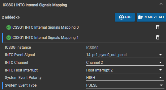

Suppose I would like to set up an interrupt handler for IEP0 pr1_sync0_out_pend.
First, I set up the "ICSSG1 INTC Internal Signals Mapping" in SysConfig GUI:
Second, I register the interrupt handler by calling RegisterISR() like below:

However, the function my_handler() is not invoked.

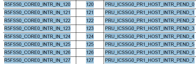

    The interrupt number which you are using above seems to be incorrect. The interrupt lines that are going from PRU_ICSSG0 to R5FSS0-0 is given in the TRM.
    Please refer below image.

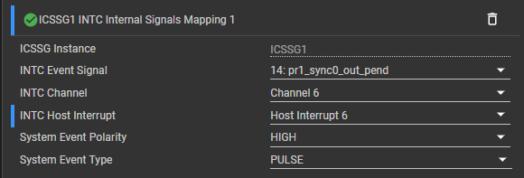

    Let me describe what I tried to do again:
    I would like to set up an interrupt service routine on R5F Core 0 when the ICSSG1 IEP0 sync_out0 happens (PRG1_IEP0_EDC_SYNC_OUT0, or equivalently compare event of IEP_CMP0_REG0/IEP_CMP0_REG1 registers ?).
    Here are what I did:
    First, start with TI MCU SDK gptp_icssg_switch example in [SDK-installed-path]\source\networking\enet\core\examples\tsn\gptp_icssg_app\gptp_icssg_switch/
    Second, use SySconfig to set the event/channel/host interrupt mapping:
    Last, call RegisterISR() below to set up the ISR.

  • Hi Matt,
    The above interrupt configuration looks correct. You should get an interrupt with this config.
    You can try one more experiment , keep the eventId = 0 and then after enabling the interrupt, call the HwiP_post(CSLR_R5FSS0_CORE0_INTR_PRU_ICSSG1_PR1_HOST_INTR_PEND_6) API to trigger the interrupt manually to verify the configuration is correct.
    similarly you can do with changing the eventId = 14 also.

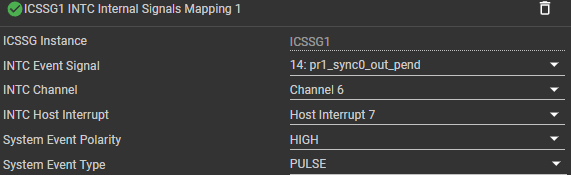

    There is a correction in the configuration that you are using. The interrupts ICSSG1_PR1_HOST_INTR_PEND_0-7 are mapped to Host interrupts 2-9 in sysconfig. So, if you are using host interrupt 6 in sysconfig gui, you would have to use _ICSSG1_PR1_HOST_INTR_PEND_8 whiule registering the HwiP interrupt.
    Please let us know if this is working for you.

  • Thank you, Teja and Nick!
    So it turned out to be the other way around:
    In SysConfig GUI, I used Host Interrupt 7:
    Plus, added the following code in icssg.c Icssg_open():
