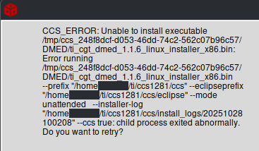

We use Code Composer Studio in several of our university courses with our students. Currently, two of our students are experiencing the same problem when attempting to install CCS version 21.8.1 on their Linux systems.
Attached are two screenshots of the error messages they received during the installation. The error text is as follows:
CCS_ERROR: Unable to install executable /tmp/cs_[id-number]/DMED/ti_cgt_dmed_1.1.6_linux_installer_x86.bin:
Error running /tmp/cs_[id-number]/DMED/ti_cgt_dmed_1.1.6_linux_installer_x86.bin
--prefix "opt/ti/ccs1281/ccs"
--eclipseprefix "opt/ti/ccs1281/ccs/eclipse"
--mode unattended
--installer-log ""opt/ti/ccs1281/ccs/install_logs/[id-number]"
--ccs true: child process exited abnormally.

  • Hello Michael,
    here the end of ccs_install_12.8.1.00005.log, lines 19837...19878, where I found some entries concerning the DMED script error:
    [10:37:15] CCS_INFO: Done installing zip file TIREX4 tirex_4.15.0.202309151451_ccs.zip
    Creating directory /tmp/ccs_39d644a1-837f-4885-6cf3-68d365ab2090/DMED
    Creating directory /tmp/ccs_39d644a1-837f-4885-6cf3-68d365ab2090/DMED/features
    Unpacking files
    Unpacking /tmp/ccs_39d644a1-837f-4885-6cf3-68d365ab2090/DMED/ti_cgt_dmed_1.1.6_linux_installer_x86.bin
    Unpacking /tmp/ccs_39d644a1-837f-4885-6cf3-68d365ab2090/DMED/content.xml
    Unpacking /tmp/ccs_39d644a1-837f-4885-6cf3-68d365ab2090/DMED/artifacts.xml
    Unpacking /tmp/ccs_39d644a1-837f-4885-6cf3-68d365ab2090/DMED/features/com.ti.cgt.dmed.linux_1.1.6.jar
    [10:37:15] CCS_INFO: Installing DMED
    Executing chmod -R 755 "/tmp/ccs_39d644a1-837f-4885-6cf3-68d365ab2090/DMED/ti_cgt_dmed_1.1.6_linux_installer_x86.bin"
    Script exit code: 0
    Script output:
    Script stderr:
    [10:37:16] showprogress = false
    [10:37:16] CCS_INFO: Installing /tmp/ccs_39d644a1-837f-4885-6cf3-68d365ab2090/DMED/ti_cgt_dmed_1.1.6_linux_installer_x86.bin
    [10:37:16] CCS_INFO: Actual executable /tmp/ccs_39d644a1-837f-4885-6cf3-68d365ab2090/DMED/ti_cgt_dmed_1.1.6_linux_installer_x86.bin
    Executing /tmp/ccs_39d644a1-837f-4885-6cf3-68d365ab2090/DMED/ti_cgt_dmed_1.1.6_linux_installer_x86.bin --prefix "/opt/ti/ccs1281/ccs" --eclipseprefix "/opt/ti/ccs1281/ccs/eclipse" --mode unattended   --installer-log "/opt/ti/ccs1281/ccs/install_logs/20251105103319" --ccs true
    Script exit code: 1
    Script output:
     Unable to initialize installer.
    Is /tmp writable ?
    Is SELinux enabled? You may need to disable it temporarily
    Please see below for details
    http://docs.fedoraproject.org/en-US/Fedora/13/html/SELinux_FAQ/index.html#id3037154
    Script stderr:
    Error running /tmp/ccs_39d644a1-837f-4885-6cf3-68d365ab2090/DMED/ti_cgt_dmed_1.1.6_linux_installer_x86.bin --prefix "/opt/ti/ccs1281/ccs" --eclipseprefix "/opt/ti/ccs1281/ccs/eclipse" --mode unattended   --installer-log "/opt/ti/ccs1281/ccs/install_logs/20251105103319" --ccs true: child process exited abnormally
    [10:56:53] CCS_ERROR: Unable to install executable /tmp/ccs_39d644a1-837f-4885-6cf3-68d365ab2090/DMED/ti_cgt_dmed_1.1.6_linux_installer_x86.bin: Error running /tmp/ccs_39d644a1-837f-4885-6cf3-68d365ab2090/DMED/ti_cgt_dmed_1.1.6_linux_installer_x86.bin --prefix "/opt/ti/ccs1281/ccs" --eclipseprefix "/opt/ti/ccs1281/ccs/eclipse" --mode unattended   --installer-log "/opt/ti/ccs1281/ccs/install_logs/20251105103319" --ccs true: child process exited abnormally: 1

  • Hello Robert,
    Sorry for the delayed response. We are unsure what the issue is. Arch Linux is not a supported Linux distro so we have minimal experience. That said, there are others that have successfully used CCS on it.
     Code Composer v11 and v12 not working on Linux
    https://aur.archlinux.org/packages/ccstudio
    Looks like this user had the same DMED install issue: https://aur.archlinux.org/packages/ccstudio#comment-1024213
