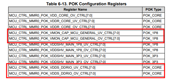

  1. What is the module type of VMON_CAP_MCU and VDDS_DDRIO?
  2. I could see the configuration thresholds settings for POK_CORE, POK_1P8 and POK_3V3. What about for POR (VDDA_MCU) ?
  • Hi Rakesh,
    You might be using an older version of TRM. Please find the latest version below:
    www.ti.com/.../spruj83b.pdf
    As defined in Table 6-13, VMON_CAP_MCU is POK_1P8 type and VDDS_DDRIO is POK_CORE type
    1. I could see the configuration thresholds settings for POK_CORE, POK_1P8 and POK_3V3. What about for POR (VDDA_MCU) ?
    Are you talking about IPOK_VDDA_PMIC_IN_UV instace? POK_VDDA_PMIC_IN is a fixed comparator; you cannot adjust the thresholds in software.
