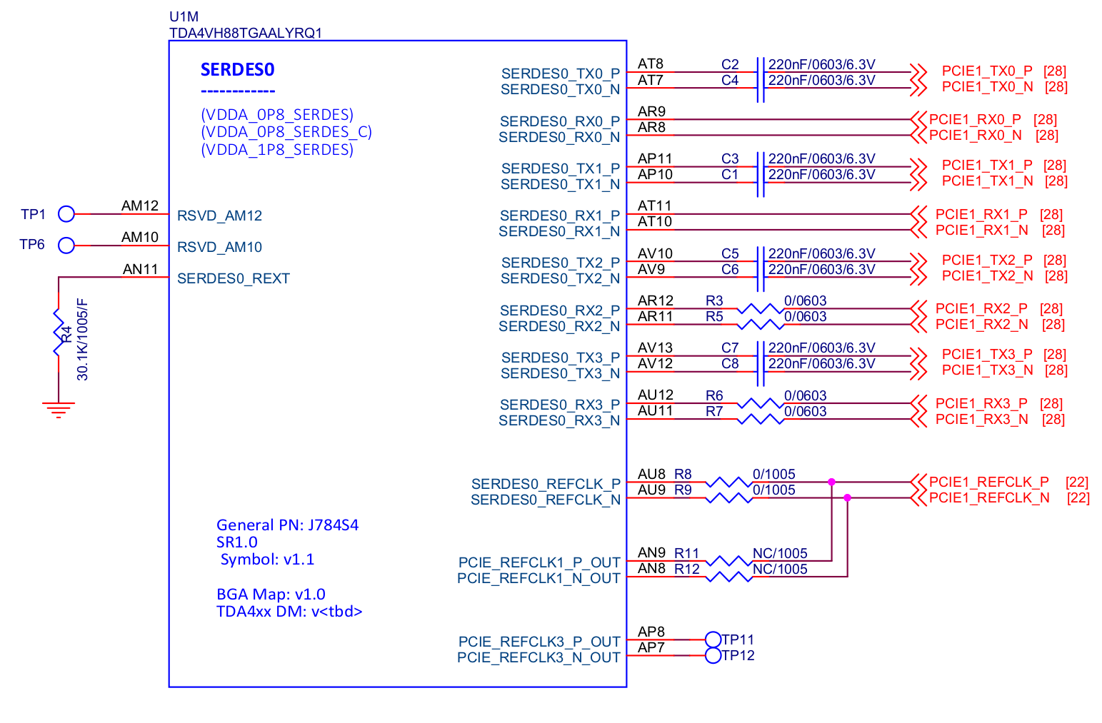

I want to use the 4-lane pcie1 connected to serdes0.
After connecting the configuration, I set the .dts file to 4 lanes, but no devices are detected.
Connecting to M.2 KEY.
But no devices are detected.
How can I debug it?

    [    7.704964] j721e-pcie-host 2910000.pcie: PCI host bridge to bus 0001:00
    [    7.704973] pci_bus 0001:00: root bus resource [bus 00-ff]
    [    7.704980] pci_bus 0001:00: root bus resource [io  0x10000-0x1ffff] (bus address [0x18001000-0x18010fff])
    [    7.704984] pci_bus 0001:00: root bus resource [mem 0x18011000-0x1fffffff]
    [    7.705016] pci 0001:00:00.0: [104c:b013] type 01 class 0x060400
    [    7.705022] pci_bus 0001:00: 2-byte config write to 0001:00:00.0 offset 0x4 may corrupt adjacent RW1C bits
    [    7.705137] pci 0001:00:00.0: supports D1
    [    7.705141] pci 0001:00:00.0: PME# supported from D0 D1 D3hot
    [    7.707171] pci 0001:00:00.0: bridge configuration invalid ([bus 00-00]), reconfiguring
    [    7.707308] pci_bus 0001:01: busn_res: [bus 01-ff] end is updated to 01
    [    7.707328] pci 0001:00:00.0: PCI bridge to [bus 01]
    [    7.707661] pcieport 0001:00:00.0: PME: Signaling with IRQ 654
    [    7.707858] pcieport 0001:00:00.0: AER: enabled with IRQ 654

    lspci :
    root@j784s4-evm:/opt/vision_apps# lspci -vvv
    0000:00:00.0 PCI bridge: Texas Instruments Device b00d (prog-if 00 [Normal decode])
    	Control: I/O- Mem- BusMaster+ SpecCycle- MemWINV- VGASnoop- ParErr- Stepping- SERR- FastB2B- DisINTx+
    	Status: Cap+ 66MHz- UDF- FastB2B- ParErr- DEVSEL=fast >TAbort- <TAbort- <MAbort- >SERR- <PERR- INTx-
    	Latency: 0
    	Interrupt: pin A routed to IRQ 650
    	Bus: primary=00, secondary=01, subordinate=01, sec-latency=0
    	I/O behind bridge: 0000f000-00000fff [disabled]
    	Memory behind bridge: fff00000-000fffff [disabled]

  • Hi Kim,
    Thanks for the logs. Looks like serdes and PCIe controller are getting configured without errors.
    Assuming this is not on the TI EVM, but could you check two things:
    1. Whether there is an external clock generator that is connected to SERDES0_REFCLK_P/N.
    2. There should be a PERST (PCIE Reset) signal, but which GPIO pin on the TDA4VH is this signal routed to? This GPIO pin should match the "reset-gpios" property of the pcie nodes in dts devicetree file.
    Takuma
  • Hi
    It is being used as follows.
    I modified the reset-gpio setting to match my board specs and verified gpio operation.
    Kim
  • Hi Kim,
    Looks good on the clock generator to SerDes connection. Could you also check clock generator to PCIe connector?
    It should look something like below:
    As for GPIO operation, was the verification done with a scope connection?
    Takuma

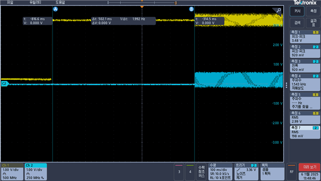

  • HI
    Yello = PERST
    Blue = REFCLK
    Below is PCIE0. It doesn't match the PCIE configuration order, but it is recognized normally.
    Below is PCIE1. It doesn't match the PCIE configuration order, but the one below doesn't work properly.
    Kim
  • Hi Kim,
    I do not think the picture posted. But could you repost the picture?
    In any case, the picture posted for PCIE0 does not look right. PERST signal should be constant, and it should be deasserted after refclk starts toggling.
    But assuming both PCIE0 and PCIE1 are showing the same scope readings, and one is working while the other is not, there are some differences between PCIE0 and PCIE1 in dts: https://git.ti.com/cgit/ti-linux-kernel/ti-linux-kernel/tree/arch/arm64/boot/dts/ti/k3-j784s4-main.dtsi?h=ti-linux-6.6.y#n1109
    Mainly differences in using internal vs external clock: https://git.ti.com/cgit/ti-linux-kernel/ti-linux-kernel/commit/arch/arm64/boot/dts/ti/k3-j784s4-main.dtsi?h=ti-linux-6.6.y&id=bb4442cd523d6e34c5db43fd78c9f579d6937f6a
    So if hardware clock connections are the same between PCIE0 and PCIE1 on your custom board, then an experiment to try would be to see if changing the dts to match the working PCIe port.

  • Hi Kim,
    Understood. Let me know if you see any improvements in behavior.
    Otherwise, thanks for sharing the second screenshot. The PERST signal oscillating and refclk starting to oscillate after PERST is a bit unexpected. For context, my expectation is something like below from PCIe specifications. Although, I think in our case the refclk signal should start at power up of board since it is provided from a external clock source.
    However, I come mainly from a software background, so let me route this question to our hardware team to get their comment.
    Takuma
  • Hi Kim,
    1. Discussed with our hardware team. Could you increase the delay for PERST deassertion. It should be the delay here: https://git.ti.com/cgit/ti-linux-kernel/ti-linux-kernel/tree/drivers/pci/controller/cadence/pci-j721e.c?h=ti-linux-6.12.y#n609
    See if 100ms delay improves the power up sequencing. The PERST signal should deassert after the refclk starts clocking.
