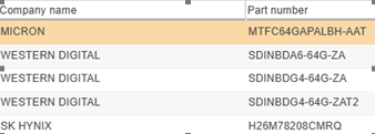

Could you help to provide the EMMC PN which can use with TDA4VM-Q1?
Also check below EMMC PN if can use:
Hi Team,
Hi Kevin,
As long as the card is compliant to the JEDEC eMMC spec v5.1, it should work just fine
