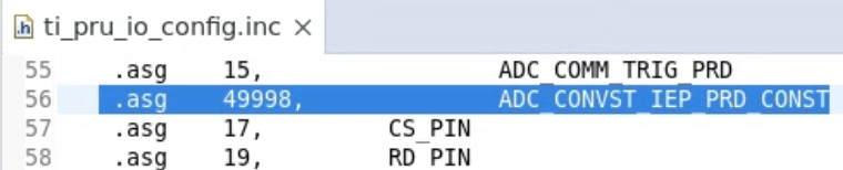

I am using TMDS64EVM with ADC-PHI-PRU-EVM and ADS8588SEVM-PDK.
I can successfully build and run the ADC example in CCS:
( mcu_plus_sdk_am64x_11_01_00_17/examples/pru_io/adc/ads85x8 )
However, I am unable to change the sampling rate.
I changed the Sampling Rate from 40,000 to 20,000 in example.syscfg file.
I checked that  ADC_CONVST_IEP_PRD_CONST was updated from 24998 to 49998 in ti_pru_io_config.inc file.
Additionally, I checked the CONVSTA signal with an oscilloscope.
Even after changing the sampling rate in example.syscfg file, the sampling interval remained 25 µs.
Could you please guide me on how to resolve this issue?

  • Hi
    After changing the setting, did you rebuild PRU project and R5F project both?
    Dhaval
  • Hello Dhaval,
    Of course, I did several times. (I tested the example in OSPI mode).
    I deleted the binaries, cleaned, and rebuilt the PRU project and R5F project both.
    SoonRyul Nam.

  • Hi
    This failure may be related. Can you manually copy the newly built "pru0_load_bin.h" to "ti/mcu_plus_sdk_am64x_11_01_00_17/examples/pru_io/adc/ads85x8/firmware/" folder and try?
    Dhaval
  • Hello Dhaval,
    I manually copied the newly built “pru0_load_bin.h” file to the folder and tried again.
    However, the result was the same as before.
    SoonRyul Nam.
  • I manually copied the newly built “pru0_load_bin.h” file to the folder and then rebuilt the projects.
    Finally, the sampling interval was successfully changed from 25µs to 50µs.
    Thank you for your help.
    SoonRyul Nam.
