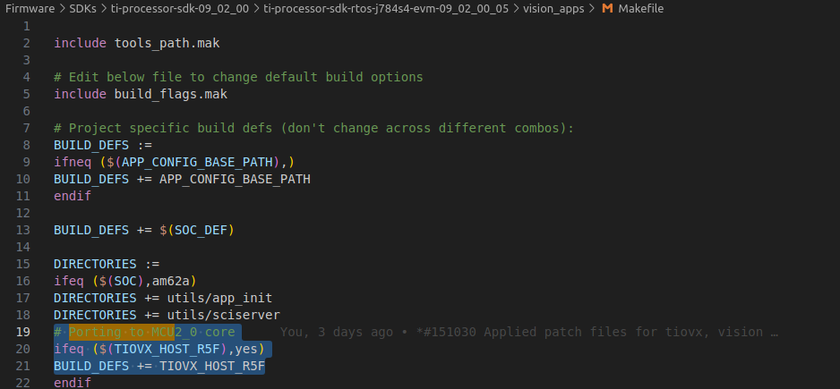

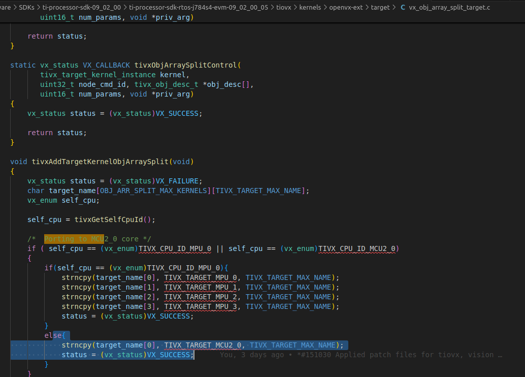

We want to make R5F as openVx host and want to exclude A72 as host and to trigger model inference from R5F itself by completely excluding A72 from this flow. So for that we found the below patches from this following forum post (https://e2e.ti.com/support/processors-group/processors/f/processors-forum/1256312/faq-tda4vm-openvx…)  for J721E 8.6 SDK.
We were working on J784S4 9.2 SDK for a custom board. While we tried to apply the complete patches, we have faced lot of build issues so we have applied required patches alone for the below source files alone,
In linux sdk,
We enabled the following flag
TIOVX_HOST_R5F = yes in tiovx build_flags.mak file and did make tiovx inside sdk_builder directory and copied the out/lib files of R5F core to the vision apps out directory of R5F core and replaced vx_app_rtos_linux_mcu2_0.out file in the custom board mcu2_0 core, and did the below steps,

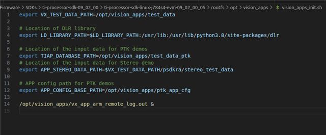

cd /opt/vision_apps
source ./vision_apps_init.sh
./run_app_c7x.sh
Already we copied the below two images inside
 /opt/vision_apps/test_data/psdkra/app_c7x
I was not able to see any difference while enabling the flag from no to yes. Is that I need to add the complete patch? But if I want to test just this simple application where I can make R5F core as host and completely excluding linux and triggering the inference from R5F itself means what and all I need to do? Could you please give some suggesstions and steps to take on this?
I am attaching the logs file in the start of the query(c7x_kernel_apptnc.txt) with the debug print statements I have added for understanding.
Thanks in advance,
Swedha R
  • Hi Swedha,
    If you run ./run_app_c7x.sh this will run linux application and a72 triggers c7x.
    I don't think these changes are sufficient enough to make r5f as host.
    This is not yet supported or tested from Ti side on sdk, only reference is the faq you pointed out in the thread, you have to port the changes manually into sdk 9.2
    Spend time to solve the build issues first and it might not be straight forward.
    Gokul
  • Hi Gokul

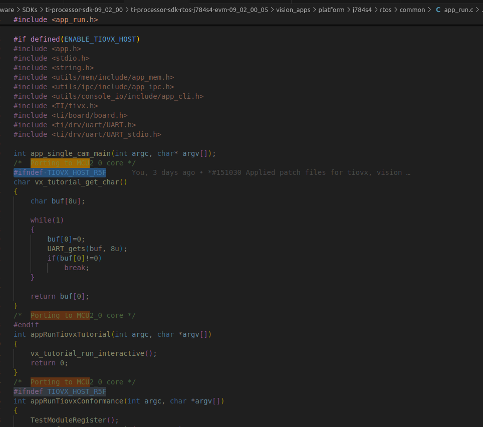

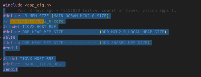

    We used the given tiovx and vision_apps patch file to SDK version (ti-processor-sdk-rtos-j784s4-evm-09_02_00_05) in order to make R5F core act as a Host for any node execution. So we made all necessary changes as shown in above screenshots and along with this we enabled the first demo application (5.1 Basic OpenVX Kernels) from this pdf file link (https://www.ti.com/lit/an/sprad48/sprad48.pdfts=1691131187626&ref_url=https%253A%252F%252Fwww.ti.com%252Fproduct%252FTDA4VM) available in the above mentioned forum link.
    Above are the changes we made in order to run the first demo application and disabled second use case. We were able to build the vision_apps and tiovx without any issues.
    Then we updated the vx_app_rtos_linux_c7x_1.out, vx_app_rtos_linux_c7x_2.out, vx_app_rtos_linux_mcu2_0.out and also copied vx_app_tutorial.out from SDKs/ti-processor-sdk-09_02_00/ti-processor-sdk-rtos-j784s4-evm-09_02_00_05/vision_apps/out/J784S4/A72/LINUX/release/vx_app_tutorial.out file  to the sd card image.
    When we ran the vx_app_tutorial.out from
    opt/vision_apps , we still see linux is only acting as host , as shown in the below logs.

    So with respect to this logs, we tried disabling the MPU1_0 from (SDKs/ti-processor-sdk-09_02_00/ti-processor-sdk-rtos-j784s4-evm-09_02_00_05/vision_apps/platform/j784s4/rtos/common/app_cfg.h) and enabling only mcu2_0 and c7x_1 for kernel and node execution.
    When we ran the vx_app_tutorial.out after updating the binaries we could confirm that Linux is still being working as host as shown in the below logs.

    Please let us know what could be the issue in the changes we made with respect to R5F core or provide us the necessary changes to be added in tiovx and vision_apps to make R5F core work as host and completely ignore linux as either host or target and need to have only dsp cores as target for node execution.

  • Hi Madhu,
    root@j784s4-evm:/opt/vision_apps# ./vx_app_tutorial.out
    Again if you run application like this it will not work. You cannot start any application from linux if you want r5f to be the host. The application start will be inside the rtos task itself.
    Gokul
  • Refer to this part,
    your r5f task will call this function and it will run the tutorial example and you have to check mcu2_0 logs to check if tutorial has completed or not.
    Follow this section to verify the application running with r5f as host. Can you please refer the appnote once.
    Gokul

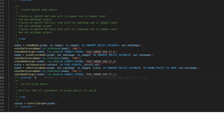

     vx_tutorial_openVX_r5_demo: Tutorial Started !!!
     1. vx_tutorial_basic_openvx_kernels: Tutorial Started !!!
     VX_TYPE_IMAGE: INPUT1, 128 x 128, 1 plane(s), 16384 B, VX_DF_IMAGE_U8 VX_COLOR_SPACE_NONE VX_CHANNEL_RANGE_FULL VX_MEMORY_TYPE_NONE, 1 refs
     VX_TYPE_IMAGE: INPUT2, 128 x 128, 1 plane(s), 16384 B, VX_DF_IMAGE_U8 VX_COLOR_SPACE_NONE VX_CHANNEL_RANGE_FULL VX_MEMORY_TYPE_NONE, 1 refs
     VX_TYPE_IMAGE: INPUT3, 128 x 128, 1 plane(s), 16384 B, VX_DF_IMAGE_U8 VX_COLOR_SPACE_NONE VX_CHANNEL_RANGE_FULL VX_MEMORY_TYPE_NONE, 1 refs
     VX_TYPE_IMAGE: INPUT4, 128 x 128, 1 plane(s), 16384 B, VX_DF_IMAGE_U8 VX_COLOR_SPACE_NONE VX_CHANNEL_RANGE_FULL VX_MEMORY_TYPE_NONE, 1 refs
     VX_TYPE_IMAGE: ADD_OUTPUT, 128 x 128, 1 plane(s), 16384 B, VX_DF_IMAGE_U8 VX_COLOR_SPACE_NONE VX_CHANNEL_RANGE_FULL VX_MEMORY_TYPE_NONE, 1 refs
     VX_TYPE_IMAGE: SUB_OUTPUT, 128 x 128, 1 plane(s), 16384 B, VX_DF_IMAGE_U8 VX_COLOR_SPACE_NONE VX_CHANNEL_RANGE_FULL VX_MEMORY_TYPE_NONE, 1 refs
     VX_TYPE_IMAGE: MUL_OUTPUT, 128 x 128, 1 plane(s), 16384 B, VX_DF_IMAGE_U8 VX_COLOR_SPACE_NONE VX_CHANNEL_RANGE_FULL VX_MEMORY_TYPE_NONE, 1 refs
       253.873536 s:  VX_ZONE_INIT:[ownTargetTaskMain:1154] Inside ownTargetTaskMain !!!
       253.874720 s:  VX_ZONE_INIT:[ownTargetDequeueObjDesc:142] Inside ownTargetDequeueObjDesc !!!
       253.874777 s:  VX_ZONE_INIT:[ownObjDescSend:269] Inside ownObjDescSend !!!
       253.874811 s:  VX_ZONE_INIT:[ownObjDescSend:299] ownIpcSendMsg called: cpu_id=0, ipc_payload=0x(nil), host_cpu_id=4, host_port_id=65535, status=0
       253.874844 s:  VX_ZONE_INIT:[ownIpcSendMsg:109] Inside ownIpcSendMsg !!!
       253.875257 s:  VX_ZONE_INIT:[ownTargetTaskMain:1190] Inside TIVX_OBJ_DESC_CMD !!!
       253.875290 s:  VX_ZONE_INIT:[ownTargetCmdDescHandler:1079] Inside ownTargetCmdDescHandler !!!
       253.875323 s:  VX_ZONE_INIT:[ownTargetDequeueObjDesc:142] Inside ownTargetDequeueObjDesc !!!
       253.875370 s:  VX_ZONE_INIT:[ownObjDescSend:269] Inside ownObjDescSend !!!
       253.875398 s:  VX_ZONE_INIT:[ownObjDescSend:299] ownIpcSendMsg called: cpu_id=0, ipc_payload=0x0x1000, host_cpu_id=4, host_port_id=65535, status=0
       253.875419 s:  VX_ZONE_INIT:[ownIpcSendMsg:109] Inside ownIpcSendMsg !!!
       253.875733 s:  VX_ZONE_INIT:[ownTargetTaskMain:1190] Inside TIVX_OBJ_DESC_CMD !!!
       253.875746 s:  VX_ZONE_INIT:[ownTargetCmdDescHandler:1079] Inside ownTargetCmdDescHandler !!!
       253.875763 s:  VX_ZONE_INIT:[ownTargetDequeueObjDesc:142] Inside ownTargetDequeueObjDesc !!!
       253.875793 s:  VX_ZONE_INIT:[ownObjDescSend:269] Inside ownObjDescSend !!!
       253.875812 s:  VX_ZONE_INIT:[ownObjDescSend:299] ownIpcSendMsg called: cpu_id=0, ipc_payload=0x0x2000, host_cpu_id=4, host_port_id=65535, status=0
       253.875823 s:  VX_ZONE_INIT:[ownIpcSendMsg:109] Inside ownIpcSendMsg !!!
       253.876099 s:  VX_ZONE_INIT:[ownTargetTaskMain:1190] Inside TIVX_OBJ_DESC_CMD !!!
       253.876110 s:  VX_ZONE_INIT:[ownTargetCmdDescHandler:1079] Inside ownTargetCmdDescHandler !!!
       253.876124 s:  VX_ZONE_INIT:[ownTargetDequeueObjDesc:142] Inside ownTargetDequeueObjDesc !!!
     VX_TYPE_GRAPH: graph_77, 3 nodes, VX_GRAPH_STATE_VERIFIED, avg perf  0.000000s, 0 parameters, 1 refs
     VX_TYPE_NODE: ADD, 4 params, avg perf  0.000000s, VX_SUCCESS, 1 refs
     VX_TYPE_NODE: SUB, 4 params, avg perf  0.000000s, VX_SUCCESS, 1 refs
     VX_TYPE_NODE: MUL, 6 params, avg perf  0.000000s, VX_SUCCESS, 1 refs
     Executing graph ...
       253.876349 s:  VX_ZONE_INIT:[ownObjDescSend:269] Inside ownObjDescSend !!!
       253.876361 s:  VX_ZONE_INIT:[ownObjDescSend:299] ownIpcSendMsg called: cpu_id=0, ipc_payload=0x0xc000, host_cpu_id=4, host_port_id=65535, status=0
       253.876370 s:  VX_ZONE_INIT:[ownIpcSendMsg:109] Inside ownIpcSendMsg !!!
       253.877061 s:  VX_ZONE_INIT:[ownTargetTaskMain:1190] Inside TIVX_OBJ_DESC_CMD !!!
       253.877074 s:  VX_ZONE_INIT:[ownTargetCmdDescHandler:1079] Inside ownTargetCmdDescHandler !!!
     Executing graph ... Done !!!
     VX_TYPE_GRAPH: graph_77, 3 nodes, VX_GRAPH_STATE_COMPLETED, avg perf  0.000778s, 0 parameters, 1 refs
       253.877131 s:  VX_ZONE_INIT:[ownTargetDequeueObjDesc:142] Inside ownTargetDequeueObjDesc !!!
     VX_TYPE_NODE: ADD, 4 params, avg perf  0.000065s, VX_SUCCESS, 1 refs
     VX_TYPE_NODE: SUB, 4 params, avg perf  0.000065s, VX_SUCCESS, 1 refs
     VX_TYPE_NODE: MUL, 6 params, avg perf  0.000070s, VX_SUCCESS, 1 refs
    Arithmetic Operation Success!! Final Output = 16

  • Hi Swedha,
    As said earlier you should not run the application from linux "./vx_app_tutorial.out"
    you should see from the remote core logs only, mcu2_0. But right now only some are visible for that you can add some delay before your application start in r5f code so that it starts executing after you run the script "source vision_apps_init.sh" . This way we can see the latest logs from mcu2_0 that should show you the status of the applicaition,
    When sending logs please use the code box,
    Gokul
  • Hi Gokul,
    Thanks for the response.
    So what you are trying to say is, we need to run the source vision_apps_init.sh in linux console under /opt/vision_apps path and we need to add any while loop like the below in the app_run.c function and load the vx_app_rtos_linux_mcu2_0.out via ccs and after the running the vision apps init script, we need to stop the while loop by modifying the variable bWaitToDebug to 0 and then this function will run in rtos core. Is that correct?
    volatile uint32_t u32LoopCount = 0;
        volatile bool bWaitToDebug = 1;
        while(bWaitToDebug)
            u32LoopCount++;
    Thanks in advance,
    Swedha R
  • Hi Swedha,
    Yes, but you don't have to load the firmware again using ccs let the existing firmware can wait on that loop and once you ran vision_apps_init.sh script you can unblock the loop, or instead of debug loop you can add a delay (with a calculated time) that waits until your linux boots and runs vision_apps_init.sh.
    Gokul
  • Hi  ,
    But I have one doubt. We are already getting all the logs right? Then how while adding delay, it will come from mcu2_0 core? Because even adding delay, we are going to run the ./vx_app_tutorial.out from linux console only right?
    Added the above delay and ran the vision apps init script and ran ./vx_app_tutorial.out. Still getting the same logs.
    Thanks in advance
    Swedha R
  • Hi Swedha,
    This is because the way "source visiion_apps_init.sh" script works. It will first fetch the logs that are available in the log_shared_memroy which will be used by remote cores to print logs. The data in this memory is available once your remote core is booted up.
    From your logs I could see the mcu2_0 logs are missed out after some point, that because first time execution of the script will fetch and print only limited logs for each remote cores and then a process will run in the background which will be collecting the logs in runtime ( which will not miss out any logs)
    So I asked to add delay in initialization of mcu2_0 code so that once you ran the script then your init will be happening in mcu2_0 and you will not miss out any logs.
    You have to correct your understanding, refer to the Application note once again.
    You should not run tiovx based application from linux ( which eventually acts like linux is the host)
    In r5f patch inside app_run_task() there is a function vx_tutuorial_run_interactive() this is the actual application which involves creation of graph and trigering the nodes from r5f. Similar code will be available in source code of ./vx_app_tutorial.out (which run on linux).
    In RTOS we cannot dynamically run our application like linux, so we have to start our application inside the rtos task that starts as soon as the scheduler is up.
    vx_tutuorial_run_interactive() is the actual application running r5f as host and you can verify this only by looking into the logs.
    Gokul

    • So I removed all the debug print statements and tested. Demo was working in J784S4.
    • There is no while loop issue and all. While running the vision_apps_init.sh script, we will be getting these logs from remote cores.
    • When analysed the above script,
    • The vx_app_arm_remote_log.out is responsible for capturing logs from remote cores while their respective application ran while booting and will store it in a shared memory.
    • While running this script, it will print all the logs stored in the shared memory. Due to more debug print statements, it was not able to collect all the logs. So I believe, this could be the issue we were not able to see the demo working even it worked.
    • Because the only way to see the working of remote core applications via linux terminal is by having this remote application. Or we need to debug via CCS.
    • But for the below target configuration, we found the below logs
    • When I changed all the target nodes to c7x_2, I am not facing the above issue.
    • I have started analysing how the demo got working in C7X_2.
    • When I was going through the Makefiles, I found the support for the openVX kernels on C7X target.
    • openvx core library getting generated for c7x target,
    • Gave vxlib support and that particular tiovx libraries are linked with c7x
    • To register the openvx core target kernels, this particular function was getting called for our SOC,
    • With the above things, we can confirm it have support on c7x core.
    • But why only for c7x_2, when I analysed in that angle, I found some informations,
    • In c7x_2 Makefile, we found support for c66 kernels in c7x_2
    • But not in c7x_1 Makefile,
    • When I tried for diff target configurations, by adding debug print statements, I found, the kernel has only support for c7x_2 target.
    • For the below configuration,
    • So with the above analysation, I confirmed it support only for c7x_2.
    • Even I tried to add support for the c7x_1, but it is not working.
    • And even we didn't set the target node explicitly, it will take the default target registered for that kernel, while graph verification.
    for this you can try the following method,
