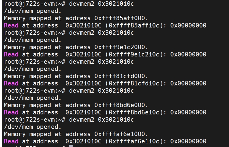

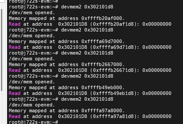

  • Hi
      When error happens, could you please dump the register 0x30210000UL + 0x1d8  and 0x30210000UL + 0x10c  to check the status? Thanks.
    Linjun
  • Hi Linjun,
    Please view the result of the register through the screenshot below.
    In addition, we can reproduce the same exception using the gst command on the EVM board. The steps are as follows:

  • I am not sure what' the status the register dumped.  the register 0 means no error reported in decoder or encoder.
  • HI Linjun,
    Actually, I couldn't find any relevant descriptions for registers 0x30210000UL+0x1d8 and 0x30210000UL+0x10c in the table "J722S-excel_ppublic_combinated.xlsx".But we dumped all the registers related to the codec in both normal and abnormal situations. Do you think it helped you in any way?
    VEN_encode_Regs_dump.zip

  • Hi Xie,
        The issue is easy reproduced or not?
         Could you please send command  0x0 to register 0x30210104 ,then read the register 0x30210000UL+0x10c for the result when issue happened. Thanks.
    BR,
    Linjun
  • Hi Linjin,
    Including the EVM board and our own board, we have enough test benches to reproduce the problem, and we can reproduce it almost every day.
    Are you saying that before each encoding, I need to set register 0x30210104 to 0 before starting encoding? When an exception occurs, I need the value of register 0x30210000UL+0x10c. Is that correct?
    BR.
  • Hi xie,
        Write 0x0 to 0x30210104 is to get the status info, then read the register 0x3021010c is get the info. maybe we could get codec system error if any error happened.  it's not before the encoding start; it's after the codec exception happens.  we can have an online debug if CCS connection is ready to your system.
    BR.
    Linjun
