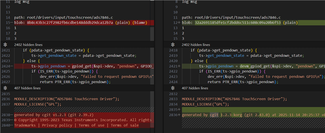

1. ADS7846 Driver Loaded
$ cat /sys/bus/spi/devices/spi0.1/modalias
spi:ads7846
2. Both SPI Devices Registered
$ ls -la /sys/bus/spi/devices/
spi0.0 -> Display
spi0.1 -> Touchscreen
3. Device Nodes Present
/dev/spidev0.0 → Display
/dev/input/event2 → Touchscreen
4. Interrupt Count Increases on Touch
Before touch: 75857
After touch:  77781
5. SPI Transactions Occurring (verified through /sys/class/spi_master/spi0/statistics)
  • Byte count and message count increase when the screen is touched.
6. GPIO Verified
SODIMM_212 configured as Touch Interrupt (gpio-535 | pendown)
The GPIO input correctly transitions from high → low → high when touching and releasing the screen.
7. pen_down Value Always 0
$ cat /sys/bus/spi/devices/spi0.1/pen_down
0
Expected: The value should go 1 when touched, but it remains 0 always.

Summary
  • ADS7846 driver is successfully probed and interrupts are triggered on touch.
  • SPI transactions are occurring correctly.
  • GPIO input toggles as expected on touch.
  • However, pen_down value remains 0, and evtest does not display any touch coordinates.
Could you please review and suggest what might be causing the pen_down status to remain low and why touch coordinates are not reported despite valid SPI and interrupt activity?
Also, can we use shared bus for both display and touchscreen? Did touch controller (ADS7846) demands seperate bus?
