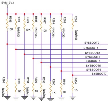

Create this thread is just for double checking with SD boot pin definion.
Customer claimed SD boot mode pin definition already change for latest chip release (TDA2EGBHQCBDQ1)
Does it have any change?

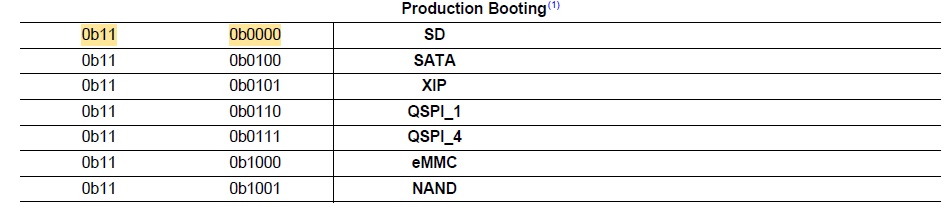

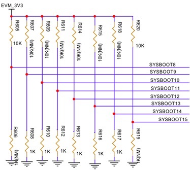

Share information what I know, I think SD BOOT should be,
SYSBOOT(SW2)[1:16] = sysboot [0-15] = 00001100 10000001

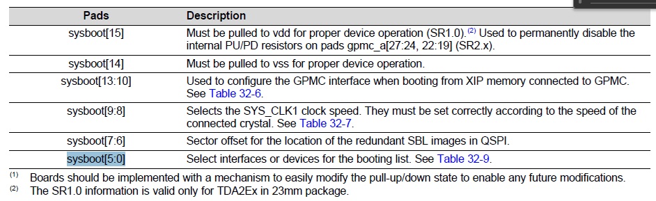

sysboot[0-5] = 0000, it means SD BOOT
I already saw the latest version TRM (Ver D)  and datasheet (Ver G), so SD boot pin define should be no change, is it correct?
