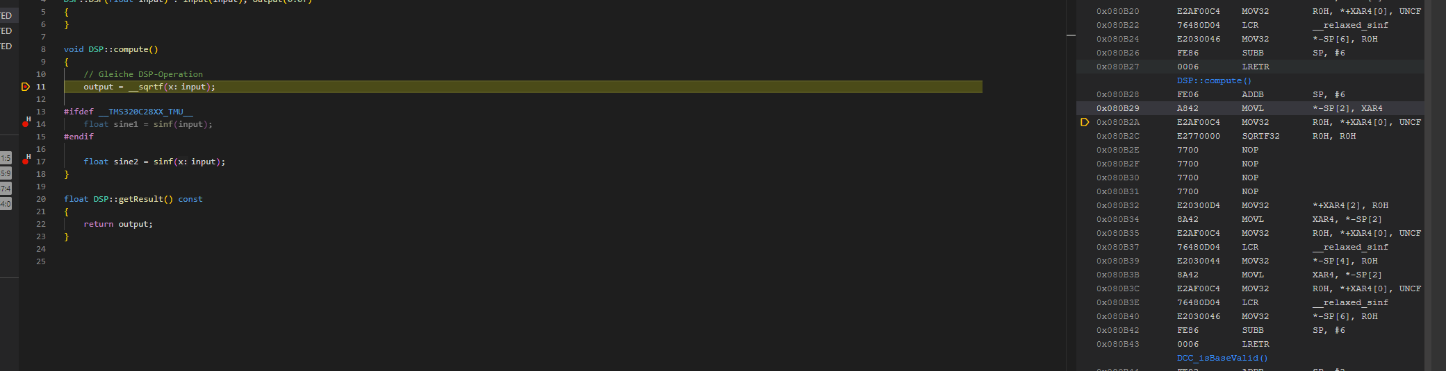

Hi folks,

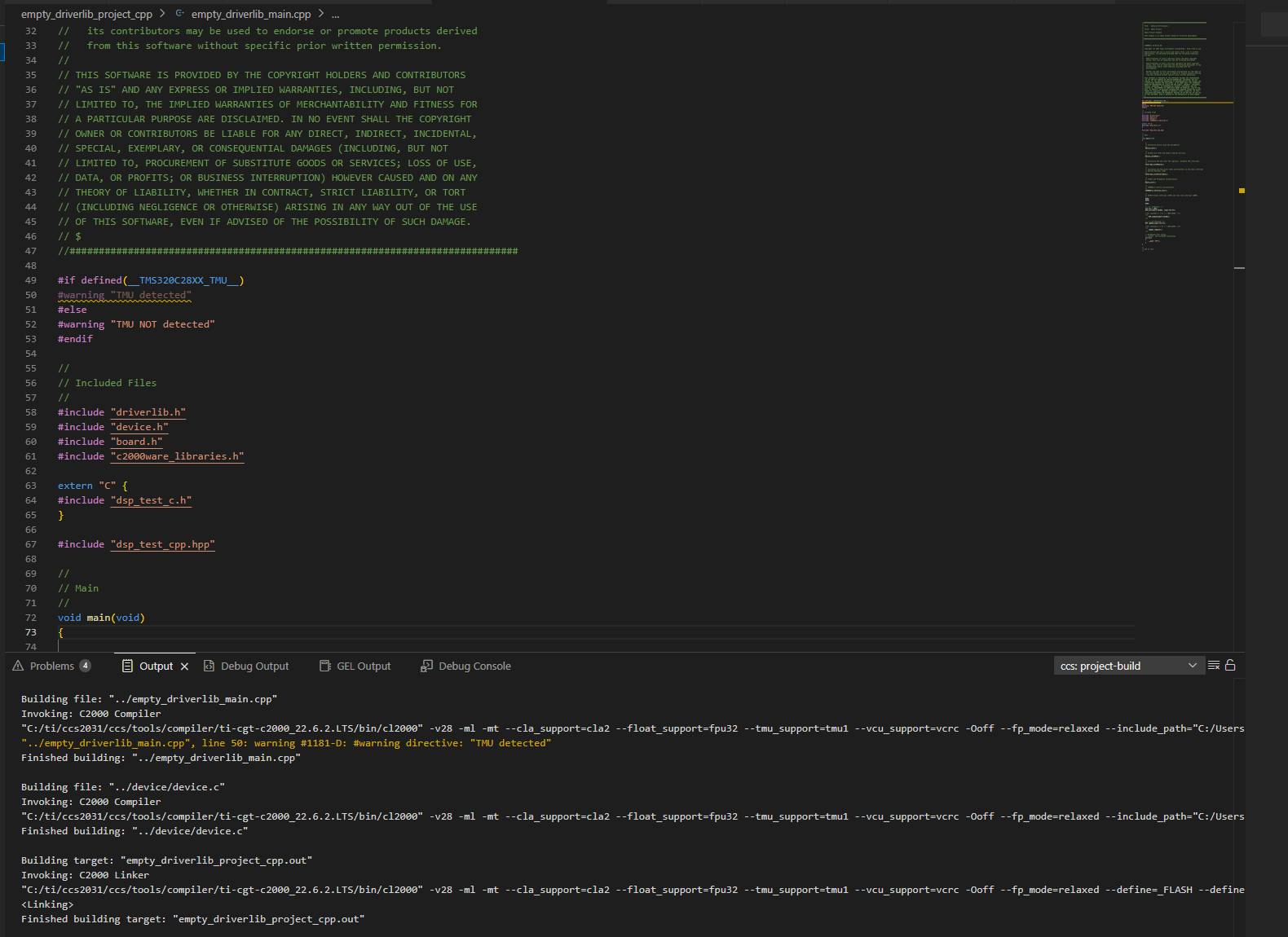

I was trying out some DSP functions and noticed that code highlighting with pre defined macro names doesn't work properly. First I though my DSP(TMU) setup (tmu on, fpu32, float relaxed) was not right and further tested. My code worked with CCS Theia 1.5.1, but doesn't seem to work with CCS 20.3.1 (Theia based) at first.
But after further testing disassambly shows the expected code lines, so DSP is working (but not the highlighting)!
Sadly, I found nohing (expect 8 year old posts) on the fly regarding this topic in this forum. So, if you stumble over my thread, don't get confused like myself.

    Second, you got me there, which made me thinking. So I checked once more with 1.5.1 Theia, and I can confirm, code highlighting doesn´t work there either with with pre defined macro names. To be honest, on Theia 1.5.1 i just tried out a simple "__sqrtf()" instruction, glanced at the headers and thought the pre defined macros are working there. Then a colleague told me about CCS 20.3.1, installed and I switched to this IDE. There I tried if "sinf()" will be replaced with the TMU provided "__releaxed_sinf()". I added the #ifdef __TMS320C28XX_TMU__ around the sinf(). Thought at first my TMU setup was wrong and then tried out different things. The #warning TMU detected confirmerd it for me, TMU is working and something must be wrong with code highlighting.
    In short: I was troubleshooting why my code seemed to be not working (Side note: Set optimization to 3 - Interprocedure and 5 - Speed made it more confusing too... my bad) and a not working code highlighting just made it more confusing.
    Nevertheless, I´m now using 20.3.1 and the TMU ist working, but it would be nice if this issue could be fixed in the future.

    I am pretty sure this is a known issue with a plan to fix. I'll need to confirm this.
  • I am pretty sure this is a known issue with a plan to fix. I'll need to confirm this.
    The are a few known issues with the syntax highlighting, including this one. We are looking to address in a future release.
