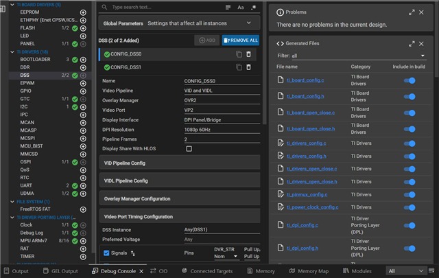

My requirement: I want to perform OLDI output on DSS1. The relevant output channels are as shown in the following figure.
My question:
1.The TI example is only about DSS0. Could you provide an example about the DSS1 module.
2. I referred to dss0 and set the relevant configuration on DSS1, but there was no clock waveform output. Is it supported to configure OLDI on DSS1
  • Hello Q W,
    I've just imported the C:\ti\mcu_plus_sdk_am62px_11_01_01_08\examples\drivers\dss\dss_display_test in my CCS Studio 20.2.0.12, and there seem to be 2 instances of the DSS:
    I do NOT have a AM62P SKEVM to test a clock. Also as I am not a DSS software expert I can NOT tell you what you might have missed when you imported an edited SDK example or your own driver.
    Please try and let me know whether both the AM62P DSS0 and DSS1 are visible for you in the CCS Studio when you import the example.
