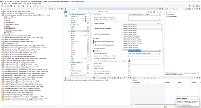

    I saw in TRM that it supports 16bit RAW data, but in syscfg I don't see to have that option too choose.
    Dimitra
  • Hi Dimitra,
    You can change the data format in "Data Format" in syscfg as shown in the above screen shot!
    Ming
