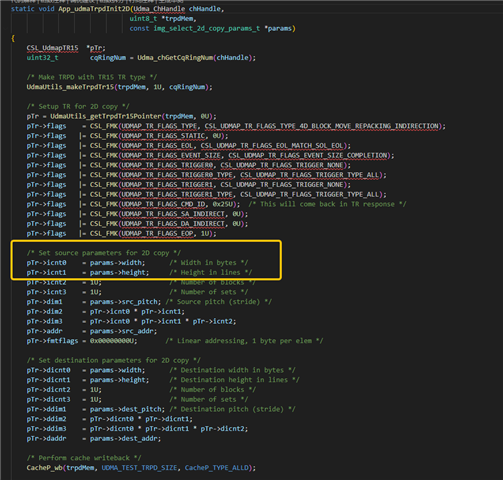

    I successfully used UDMA copy as a reference example.
    But he took too long, copying a 1920 * 960 image took 70 milliseconds.
    This is my code, is there a configuration issue?
    Can you please share the code if possible.
    Sivadeep
  • Confirming again, copying YUV takes 10 milliseconds and copying BGRX takes 25 milliseconds. The time previously recorded was incorrect. Is this time normal now

    /* UDMA TRPD initialization function for 2D copy */
    static void App_udmaTrpdInit2D(Udma_ChHandle chHandle,
    uint8_t *trpdMem, const img_select_2d_copy_params_t *params)
        CSL_UdmapTR15 *pTr;
        uint32_t cqRingNum = Udma_chGetCqRingNum(chHandle);
        /* Make TRPD with TR15 TR type */
        UdmaUtils_makeTrpdTr15(trpdMem, 1U, cqRingNum);
        /* Setup TR for 2D copy */
        pTr = UdmaUtils_getTrpdTr15Pointer(trpdMem, 0U);
        pTr->flags = CSL_FMK(UDMAP_TR_FLAGS_TYPE, CSL_UDMAP_TR_FLAGS_TYPE_4D_BLOCK_MOVE_REPACKING_INDIRECTION);
        pTr->flags |= CSL_FMK(UDMAP_TR_FLAGS_STATIC, 0U);
        pTr->flags |= CSL_FMK(UDMAP_TR_FLAGS_EOL, CSL_UDMAP_TR_FLAGS_EOL_MATCH_SOL_EOL);
        pTr->flags |= CSL_FMK(UDMAP_TR_FLAGS_EVENT_SIZE, CSL_UDMAP_TR_FLAGS_EVENT_SIZE_COMPLETION);
        pTr->flags |= CSL_FMK(UDMAP_TR_FLAGS_TRIGGER0, CSL_UDMAP_TR_FLAGS_TRIGGER_NONE);
        pTr->flags |= CSL_FMK(UDMAP_TR_FLAGS_TRIGGER0_TYPE, CSL_UDMAP_TR_FLAGS_TRIGGER_TYPE_ALL);
        pTr->flags |= CSL_FMK(UDMAP_TR_FLAGS_TRIGGER1, CSL_UDMAP_TR_FLAGS_TRIGGER_NONE);
        pTr->flags |= CSL_FMK(UDMAP_TR_FLAGS_TRIGGER1_TYPE, CSL_UDMAP_TR_FLAGS_TRIGGER_TYPE_ALL);
        pTr->flags |= CSL_FMK(UDMAP_TR_FLAGS_CMD_ID, 0x25U); /* This will come back in TR response */
        pTr->flags |= CSL_FMK(UDMAP_TR_FLAGS_SA_INDIRECT, 0U);
        pTr->flags |= CSL_FMK(UDMAP_TR_FLAGS_DA_INDIRECT, 0U);
        pTr->flags |= CSL_FMK(UDMAP_TR_FLAGS_EOP, 1U);
        /* Set source parameters for 2D copy */
        pTr->icnt0 = params->width; /* Width in bytes */
        pTr->icnt1 = params->height; /* Height in lines */
        pTr->icnt2 = 1U; /* Number of blocks */
        pTr->icnt3 = 1U; /* Number of sets */
        pTr->dim1 = params->src_pitch; /* Source pitch (stride) */
        pTr->dim2 = pTr->icnt0 * pTr->icnt1;
        pTr->dim3 = pTr->icnt0 * pTr->icnt1 * pTr->icnt2;
        pTr->addr = params->src_addr;
        pTr->fmtflags = 0x00000000U; /* Linear addressing, 1 byte per elem */
        /* Set destination parameters for 2D copy */
        pTr->dicnt0 = params->width; /* Destination width in bytes */
        pTr->dicnt1 = params->height; /* Destination height in lines */
        pTr->dicnt2 = 1U; /* Number of blocks */
        pTr->dicnt3 = 1U; /* Number of sets */
        pTr->ddim1 = params->dest_pitch; /* Destination pitch (stride) */
        pTr->ddim2 = pTr->dicnt0 * pTr->dicnt1;
        pTr->ddim3 = pTr->dicnt0 * pTr->dicnt1 * pTr->dicnt2;
        pTr->daddr = params->dest_addr;
        /* Perform cache writeback */
        CacheP_wb(trpdMem, UDMA_TEST_TRPD_SIZE, CacheP_TYPE_ALLD);

    /* UDMA 2D memcpy function */
    static int32_t App_udmaMemcpy2D(tivxImgSelectParams *prms, const img_select_2d_copy_params_t *params)
        int32_t retVal = UDMA_SOK;
        uint64_t pDesc;
        uint32_t trRespStatus;
        uint64_t trpdMemPhy;
        /* Initialize TRPD for 2D copy */
        App_udmaTrpdInit2D(prms->udmaChHandle, prms->udmaTrpdMem, params);
        trpdMemPhy = (uint64_t) Udma_defaultVirtToPhyFxn(prms->udmaTrpdMem, 0U, NULL);
        /* Submit TRPD to channel */
        retVal = Udma_ringQueueRaw(Udma_chGetFqRingHandle(prms->udmaChHandle), trpdMemPhy);
        if (retVal != UDMA_SOK)
            VX_PRINT(VX_ZONE_ERROR,"Failed to submit TRPD to UDMA channel\r\n");
            return retVal;
        /* Wait for completion */
        SemaphoreP_pend(&prms->udmaDoneSem, SystemP_WAIT_FOREVER);
        retVal = Udma_ringDequeueRaw(Udma_chGetCqRingHandle(prms->udmaChHandle), &pDesc);
            VX_PRINT(VX_ZONE_ERROR,"Failed to dequeue from completion ring\r\n");
            return retVal;
        /* Check TR response status */
        CacheP_inv(prms->udmaTrpdMem, UDMA_TEST_TRPD_SIZE, CacheP_TYPE_ALLD);
        trRespStatus = UdmaUtils_getTrpdTr15Response(prms->udmaTrpdMem, 1U, 0U);
        if (CSL_UDMAP_TR_RESPONSE_STATUS_COMPLETE != trRespStatus)
            VX_PRINT(VX_ZONE_ERROR,"UDMA 2D transfer failed with status: %d\r\n", trRespStatus);
            retVal = UDMA_EFAIL;
            return retVal;
        return retVal;

    In this TRPD initialization function, the checks are in place, right? To measure the transfer time, you should only consider the time from DMA submission to completion.
