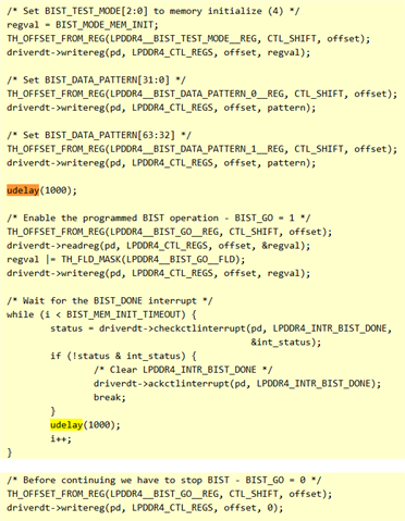

DRA829J: DDR BIST initialization delay
Part Number: DRA829J
Dear TI team,
Regarding commit 5de948718fab:
In line 623, is udelay(1000) in your implementation required before enabling priming?
(Right before /* Enable the programmed BIST operation - BIST_GO = 1 */)
Our implementation:
We use the same BIST mechanism in our bootloader but we did not add this delay.
We configure BIST registers, start the priming and enter a loop to check (by polling), the priming status.
Our implementation is working, but we found this delay deviation and we need to confirm if this is required.
I did not find references for the necessity of this delay, could you enlighten me please?
Thank you,
João Simões
