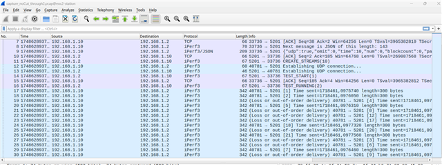

We noticed in capture.pcap wrong order of packages.
   17  22.637991 192.168.1.100 → 192.168.1.2  iPerf3 342 (Loss or out-of-order delivery) 34671 → 5201 [4] Time sent=1454188,4972730 length=300 bytes
   18  22.637993 192.168.1.100 → 192.168.1.2  iPerf3 342 (Loss or out-of-order delivery) 34671 → 5201 [1] Time sent=1454188,4972120 length=300 bytes
   19  22.638036 192.168.1.100 → 192.168.1.2  iPerf3 342 34671 → 5201 [2] Time sent=1454188,4972560 length=300 bytes
   20  22.638037 192.168.1.100 → 192.168.1.2  iPerf3 342 (Loss or out-of-order delivery) 34671 → 5201 [7] Time sent=1454188,4972950 length=300 bytes
   21  22.638046 192.168.1.100 → 192.168.1.2  iPerf3 342 (Loss or out-of-order delivery) 34671 → 5201 [3] Time sent=1454188,4972640 length=300 bytes
   22  22.638047 192.168.1.100 → 192.168.1.2  iPerf3 342 (Loss or out-of-order delivery) 34671 → 5201 [8] Time sent=1454188,4973020 length=300 bytes
   23  22.638052 192.168.1.100 → 192.168.1.2  iPerf3 342 (Loss or out-of-order delivery) 34671 → 5201 [5] Time sent=1454188,4972810 length=300 bytes
   24  22.638057 192.168.1.100 → 192.168.1.2  iPerf3 342 34671 → 5201 [6] Time sent=1454188,4972880 length=300 bytes
Our understanding is that "Frames going to wrong order is allowed with HSR and PRP when link breaks occur, but not in fully functional network. "

  • Hi Milan,
    Please share with us the original Wireshark capture with the issue
    Please try updating to the latest firmware (this version will be integrated into the next SDK release 11.2) https://git.ti.com/cgit/processor-firmware/ti-linux-firmware/commit/?h=ti-linux-firmware&id=dccce744ba744783ced6ffd031d50b54cf5e787e
    Summary of suggestions to test out below:
    1. Try the same test without Redbox
    2. Try the same test without cut-through
    -Daolin
  • Hi Daolin
    We will provide message by message for different tests.
    TC01 : AM64x + WITH RedBox + SDK Version PRU Firmware + without cut-through enable
    Output :
    - Order is still not good (see attached file)
    - We notice this up/down multiple times on EVM1 the cable attached to RedBox
    root@EVM1:~# # Before UDP
    root@EVM1:~# [ 3813.988928] icssg-prueth icssg1-eth eth2: Link is Down
    [ 3815.013697] icssg-prueth icssg1-eth eth2: Link is Up - 1Gbps/Full - flow controf
    [ 3817.060963] icssg-prueth icssg1-eth eth2: Link is Down
    [ 3818.085717] icssg-prueth icssg1-eth eth2: Link is Up - 1Gbps/Full - flow controf
    [ 3819.108972] icssg-prueth icssg1-eth eth2: Link is Down
    [ 3820.133854] icssg-prueth icssg1-eth eth2: Link is Up - 1Gbps/Full - flow controf
    [ 3822.180984] icssg-prueth icssg1-eth eth2: Link is Down
    [ 3823.205841] icssg-prueth icssg1-eth eth2: Link is Up - 1Gbps/Full - flow controf
    [ 3824.228954] icssg-prueth icssg1-eth eth2: Link is Down
    [ 3825.253740] icssg-prueth icssg1-eth eth2: Link is Up - 1Gbps/Full - flow contro
    tc01.zip
  • TC02 : AM64x + WITHOUT RedBox + SDK Version PRU Firmware + without cut-through enable
    Output :
    - Order is good (see attached file)
    tc02.zip
    I would suspect that the use case :
    When a device that is
    - not in HSR Ring,
    - try to communicate with device in UDP in HSR Ring
    - Packet Order is good
    How can u on your side to test this use case ?
    - Tianyi

  • Hi Daolin,
    Sorry for the typo. About TC02 : AM64x + WITHOUT RedBox + SDK Version PRU Firmware + without cut-through enable I find same behavior than you. Packets order are good
    Based on the observation, I suspect either the Root Cause comes from
    ==> 1 - Redbox behavior which can mix packets order as u mentioned earlier.
    ==> 2 - how AM64x handle packets that are not in HSR Ring.
    To eliminate 1, do you have a Profishark on your side to do the following set up ?
    PC (iperf client)--> RedBox--> Profishark --> HSR device
    And check :
    1 - Profishark output for packet order
    2 - HSR device  tcpdump output for packet order
    - Tianyi
  • Hi Daolin I did quick test on this setup :
    PC (iperf client)--> RedBox--> Profishark --> AM64x (with tcpdump)
    Profishark output :
    Packet order is good
    AM64x:
    Packet order is not good
    Tianyi
