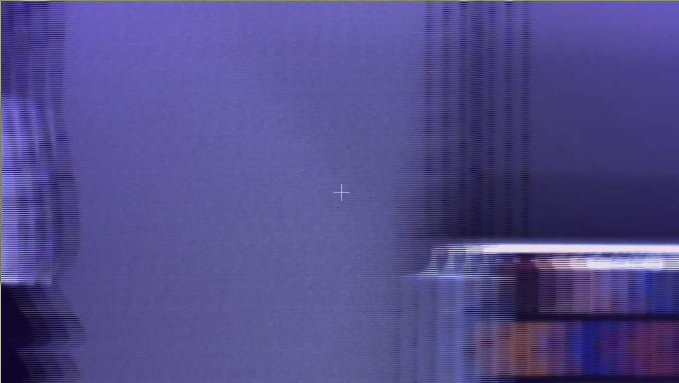

  • Vaibhav,
    I'm trying to go back and use your suggestion of on-the-fly mode for the resizer.  By default in the 2.6.32 kernel distributed with PSP 3.00.01.06, the pipeline is set up as CCDC->PREV->MEM->RSZ->MEM.  I made the changes to set it up for CCDC->PREV->RSZ->MEM.  However, when doing this I get an incorrect image as shown in the attachment to this post.
    There are several comments in isp.c regarding a workaround stemming from the OMAP3430 errata.  The exact comment is:
    ISP MMU mapped temporary buffer address used for 34xx Workaround
     *           for CCDC->PRV->RSZ datapath errata.
    I do not see any related issue in the DM3730 errata.  My question is does the DM3730 have this same problem that requires the workaround?  Or is the driver just not set up correctly for on-the-fly resizer?  I think on-the-fly mode would really help meet my frame rate requirement.
