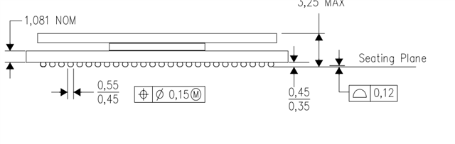

What is the minimum pad size needed for TMS320C6416TBCLZD1 IC's footprint?

Hello Nachiketh Karanth
This is part of the drawing.
Please refer below.
www.ti.com/.../TMS320C6416
FCBGA GLZ Plastic Grid Array 532
Minimum pad size is not available in the shared link.
www.ti.com/.../searchtipackages.tsp
www.ti.com/.../mpbg175e.pdf
Sreenivasa
Additional inputs received:
450um is the SMO in the substrate drawing, so I do agree that we should be recommending a 450um PCB pad size.
For reference, that is typically the pad size we use for 0.8mm pitch. If you look at other 0.8mmp devices (ex. ANF or AMB), we recommend a 450um PCB pad size
