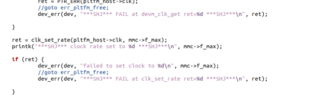

  • Hi Shanti,
    U-Boot and kernel used different mechanism to enable/detect sdcard. The kernel boot log doesn't have any mmc1 related message, so the problem is either in kernel devicetree, kernel mmc related drivers/modules, or something else, but I am not sure what the problem is. You first can debug the kernel function sdhci_omap_probe() in  drivers/mmc/host/sdhci-omap.c, for example, by add kernel printk in some places to see if this function fails at anywhere.
  • Hello Bin,

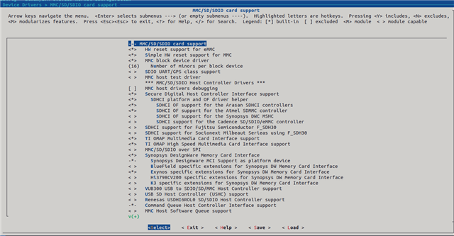

    Thank you for your suggestion. Below is the log with kernel prints in sdhci_omap_probe() function. Probe function's prints are tagged with "***SHJ***" for easy search.
    Also I'm pasting the screenshot of menuconfig here. I see no error message function from probe(), but clk rate set to 0.. I'm attaching the sreenshot of cle set section of code also for your reference.
    Thank you,
    Shanti
    Menuconfig:

  • Hi Shanti,
    clk_set_rate() returning 0 means the function runs successfully, it doesn't mean the clk rate is set to 0.
    But now I see the log has message:
    [ 2.192639] sdhci-omap 48060000.mmc: Error applying setting, reverse things back
    which is printed from the pinmux driver - drivers/pinctrl/core.c. It seems you have mmc1 pinmux error, please review your device tree mmc1 pinmux.

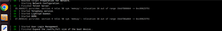

  • Hello Bin,
    Thank you very much for your prompt replies. As you suggested, I reviewed all pinmux of my custom board and I found that very few pins ofmy custom board had been used in TI SDK for some other purpose.  I commented/disabled those lines or nodes and it worked. MMC was detected, kernel boot was successful and I'm able to login as root. Now I'm able to run qt demos of TI SDK on my custom board also, but on linuxfb platform.
    Now I'm working on running those demos on eglfs platform (GPU enabled), but facing problem in loading the pvrsrvkm module.(It was working fine on BBB).
    Below is the screenshot of the error.
    Also, my touchscreen is not working even though it is enabled. I'm testing the demos with mouse for time being.
    I greatly appreciate and thank you for all your help and support till this point.
    Shanti
