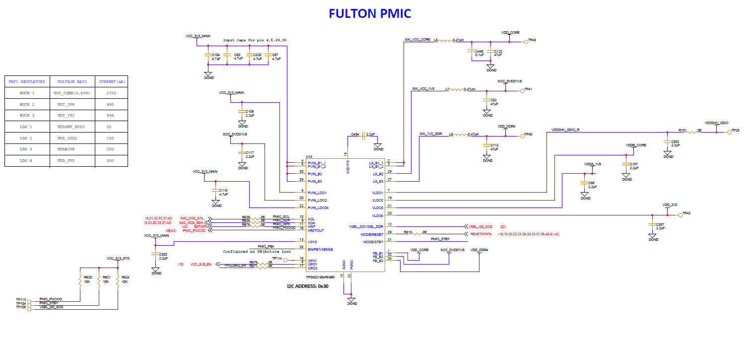

We are facing a power-up issue with TPS6521904 on a custom board and would appreciate your guidance.
PMIC Details
  • PMIC Variant: TPS6521904RHBR
  • Application: Custom SK-AM62B-P1-based board
  • Input Supply: VCC_MAIN = 3.3 V (verified stable at PMIC input)
  • PMIC Configuration:
    • Using factory TPS6521904RHBR variant
    • Power tree designed strictly as per TI SK-AM62B-P1  reference design
Enclosing the snippet of PMIC schematic used in custom board:
  • + Name updated
    Hello Mallika Vignesh,
    Thank you for the query.
    Can you probe the output rails and check if they are coming up during power-up
    Please share a searchable PDF version for review.
    Please expect delayed response due to the weekend holidays.
    Sreenivasa

    I am hereby sharing the schematics of custom board.5621.Optilink_Plus_RevC_sch.pdf
    Mallika

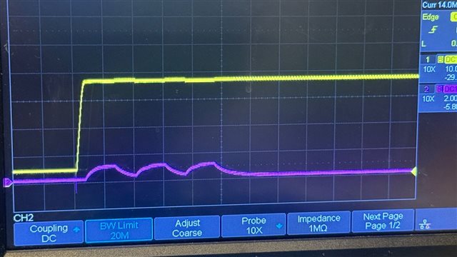

  • Hi Sreenivasa,
    We are seeing a repeatable power-up issue that appears to match the datasheet “VSYS slow ramp with FSD enabled” behavior. Sharing scope waveforms.
    Setup:
    • SoC-to-PMIC interface was isolated during this test (to avoid any SoC influence/backfeed)
    • Measurement points:
      • CH1 (Yellow): VSYS (PMIC input supply)
      • CH2 (Purple): BUCK2 output.
    Mallika
  • Hello Mallika,
    Thank you.
      Please elaborate the circuit that was isolated Did you isolate any of the supply rails?
    Can you probe all the buck outputs
    Can you explain the above waveform?
    I am not sure on the reason for the input voltage to fluctuate. Can you confirm the input voltage is stable?
    Sreenivasa
  • Hi Sreenivasa,
    PMIC outputs fully isolated from SoC and peripherals.
    PMIC powered only from its 3.3v stable input
    Here are the waveforms for all the buck outputs.
    • CH2 (Purple): BUCK1 output.
    • CH2 (Purple): BUCK3 output.
    • I am sharing the logic analyzer output where channel 2 is supply voltage and all other channels are output rails.
